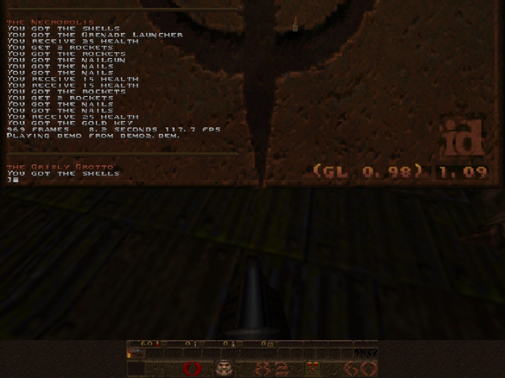

I do not have space at the moment 😀
But until I find some space and time here is a screenshot of the system running GL-Quake (32bit) using a Geforce 3.

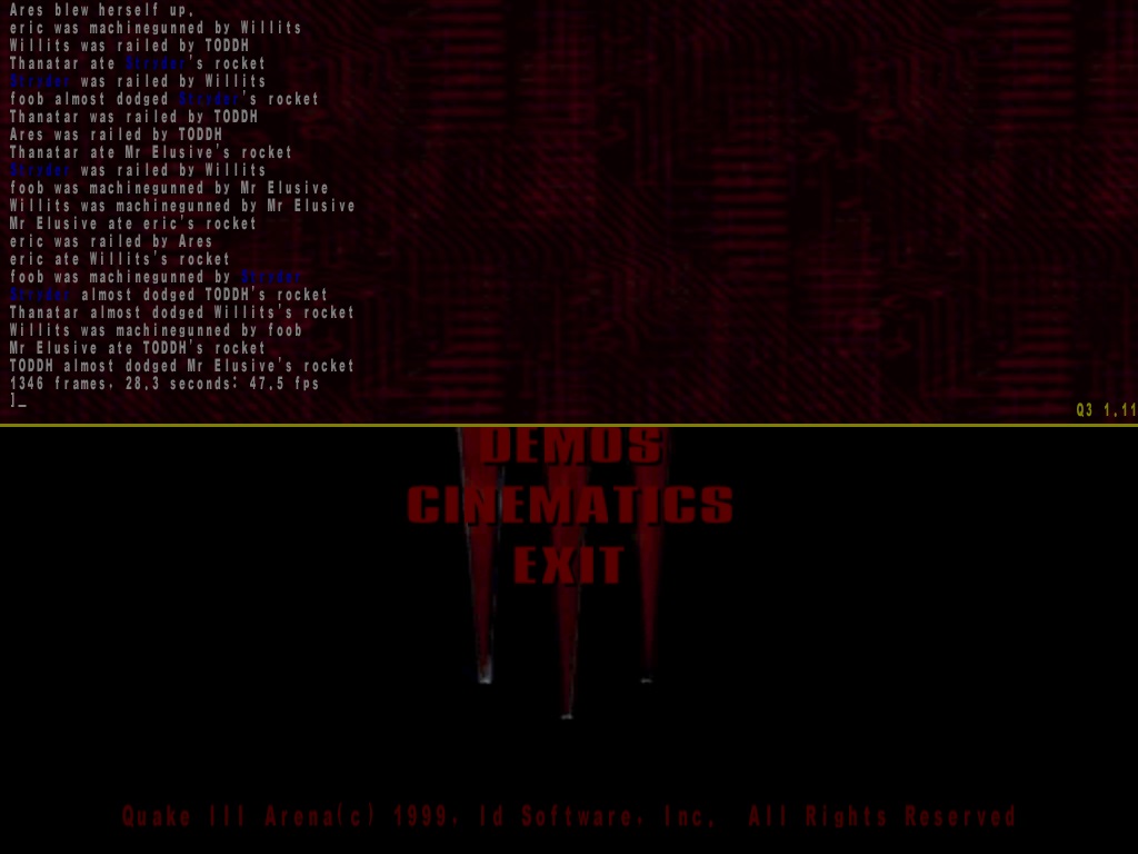

And a screenshot of the system running Quake III (32bit) using a Geforce 3
