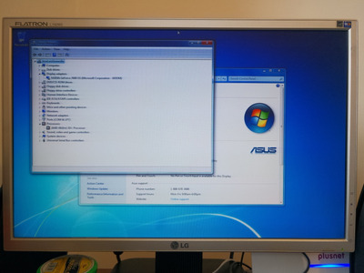

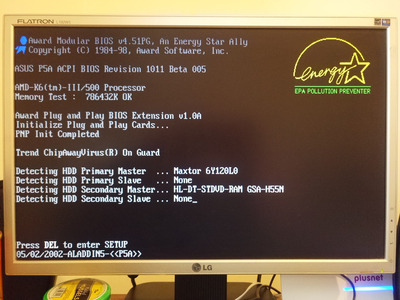

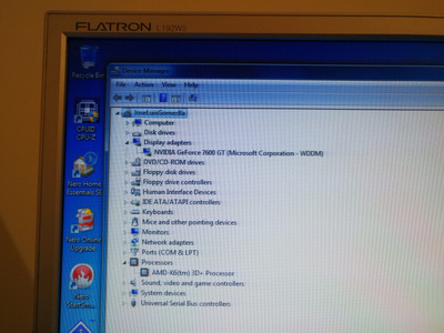

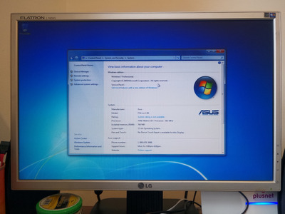

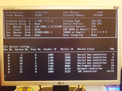

Hi kanecvr,
I'm sure the P5A rev 1.06 1MB cache is the best Super 7 motherboard has ever made, it's the cacheable area 4GB with the Aladdin V revision G chipset. It can manage 768MB of SDRAM at the same speed to 384MB. EP-MVPG5 rev 1.4 can work with 640MB and rev 1.1 can work with 768MB but both of them are half cache/memory speed with 512MB or 768MB comparing to 384MB. P5A with 768MB is almost double faster than EP-MVP3G5 and PA-2013. On the other hand the best AGP graphic card you can use on the EP-MVP3G5 is the ATI Radeon 9800SE with 256MB DDR, on the other hand the P5A can manage a Geforce 7600GS with 512MB DDR2 even with Windows 7 Professional. I tested it with a K6-III/475@500.
Does anybody know another Super 7 motherboard which can manage an AGP graphic card with 512MB DDR2 and Windows 7 Professional?. Thank you.
I've just tried another challenge, I tried one of my two Asus P5A Rev 1.06 with a Geforce 7600GT with 256MB GDDR3. I didn't expect that worked since the EPOX EP-MVP3G5, one of the best super7 motherboard doesn't work with any AGP 8X and DDR2 memory, nor GDDR3. It was unbelievable because that motherboard worked perfectly with a Geforce 7600GT AGP 8X, 256MB GDRR3 and Windows 7 Professional.

Yes, you're right. Thank you. I added some photos to my post.

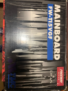

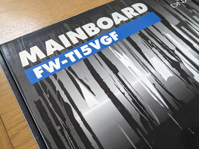

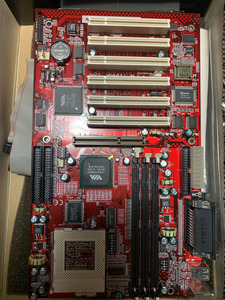

Adding Freeway FW-TI5VGF mobo 😁, to be tested soon

The Freeway seems to have just 1MB L2 Cache and the older MVP3 southbridge that´s capable of ATA33 only. Not very convincing...
If you really need 5 or 6 PCI slots it might be an option.
It has 2MB for sure. Second chip is on other side.
