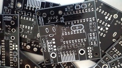

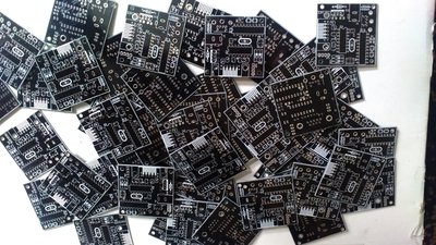

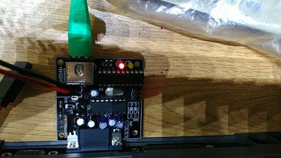

Reply 124 of 381, by matze79
Some Eyecandy.
One Error in PCB, text is black on black 😁
hopefully nothing else.

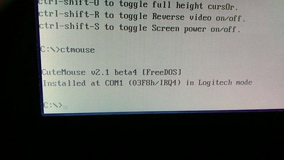

Eletrical Test Done:
191.49 KiB
1130 views
121.77 KiB
1130 views
177.34 KiB
1130 views
- Changes for next Batch Move 90 C° to allow easier bending for bracklet mounting.
- polarity of DCJACK wrong, but this is no problem at all.
So its time to order all parts.
its a pile of work to sort all kit's together... many parts and bags..

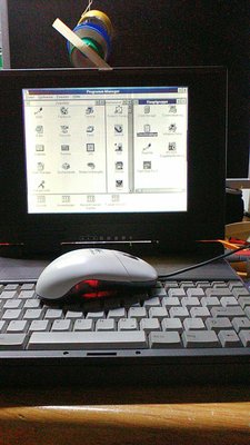

As you can see, i added a ISP Header (last minute), allowing for easy reprogramming.
Also bootloader is in progress.
My trusty 386SX Notebook serves again to test the adapter 😀

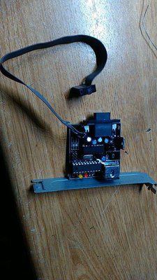

Reply 128 of 381, by matze79
Internal Mounting Idea:
211.27 KiB
1125 views
Just Drill 3 holes into the Bracklet, make 2 angles and screw together.
And a Cable to Multi I/O Controller 😀

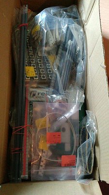

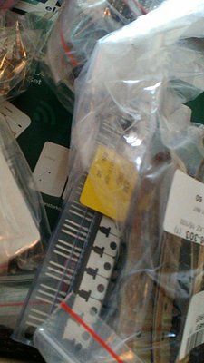

Reply 138 of 381, by matze79
Some parts arrived, the seller has split it into two packages...
some parts will arrive later, ~30 DC-Jacks are missing.
Damn!
155.42 KiB
974 views

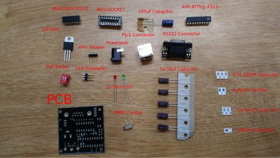

Reply 139 of 381, by matze79
First Kit:
1.86 MiB
948 views
EDIT: Diode missing... damn
