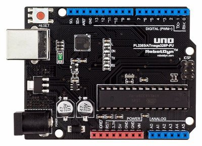

I can borrow the RobotDyn in the photo. Which has an USB interface. Maybe that will allow for firmware flashing an ATTiny? Edit: strongly doubt it.
Either way I will wait it out until the Firmware is out and the first reports of it are in.

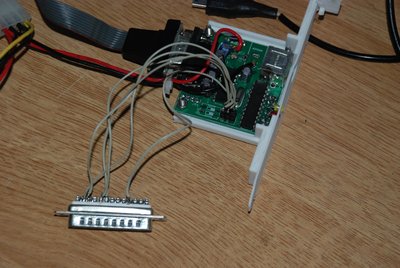

Reply 297 of 381, by matze79

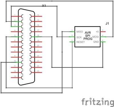

You can easily make a Cable for Upgrade from a RS232 Com2 Cable (MultiIO)
932.51 KiB
1351 views
1 MiB
1351 views
32.01 KiB
1351 views
Instruction:
https://www.instructables.com/id/Simplest-AVR … ort-programmer/
Choose ATTINY2313 and just load PS2 Adapter Hex File from the ZIP File.
Choose your LPT Printer Port.
Press Flash 😀
Warning, i use no resistors! so don't short circuit anything 😉

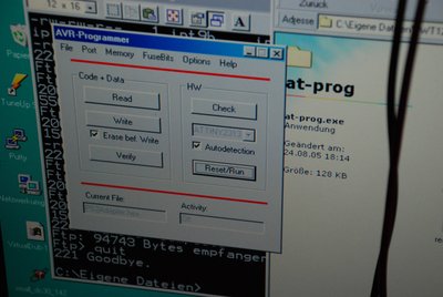

Flash Tool:
FWT1201I3TH9DY2.rar
92.52 KiB
74 downloads
Flash Tool
EDIT:
The Adapter needs to be powered for programming!
Warning: The Software does not support Versions with ATTiny4313.. need to check for one that does 😀
EDIT: ATTINY4313 can added to the Software.. i`m patching ini file, need to test values (maybe i have a tiny4313 for testing somewhere)
Add this to the ATPROG.INI File of the Flash Tool.:
ATTINY4313 1E920D 4K 32 3:0 64 9:4 256
Untested!
Maybe i should make a clean thread.
EDIT: If you have Tiny4313 Version, you can use Bootloader for Updating Firmware.
Use TinySafeBoot and load hex on your MCU trough RS232.
TinySafeBoot is found here:
http://jtxp.org/tech/tsb.zip

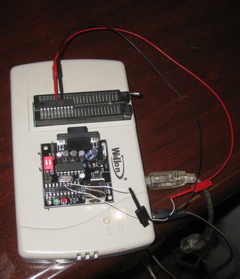

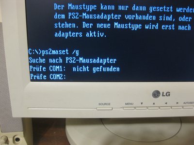

I tried to flash the ATTiny 4313-PU with my Wellon VP-390 programmer. The Wellon has an option for the 4313. It claims it programmed the *.hex file you provided, and I am able to read back the file from the ATTiny, but when I go to use the converter, the DOS mouse driver is no longer able to find a mouse. When I run ps2maset.exe /g, it hangs with the following screen:
267.52 KiB
1285 views
I have also tried attaching the EXT OSC to the ATtiny 4313 while programming it.
450.17 KiB
1285 views

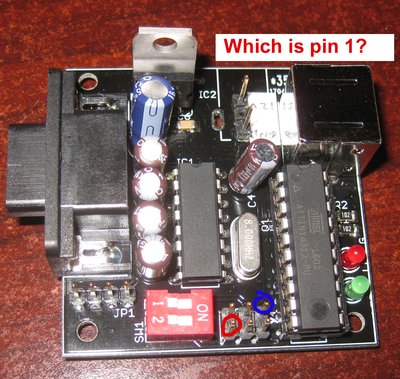

So something is buggered up. I tried to follow your "Simplest AVR Parallel Port Programmer" tutorial, but I am confused about a) which SPI pin is pin 1, my red cicle or blue circle (see image here:). I also noticed that the MCU chip on your breadboard is a lot larger than what I have. And what is that smashed silver can for? I assume its the crystal, but then you said we don't need it.
521.55 KiB
1285 views
and b) whether this will work with the 4313. You mentioned untested, but would update the ini file. When I download the FWT1201I3TH9DY2.rar and check the ini file, I see 4313 still absent. Did you determine if 4313 will work or not?
