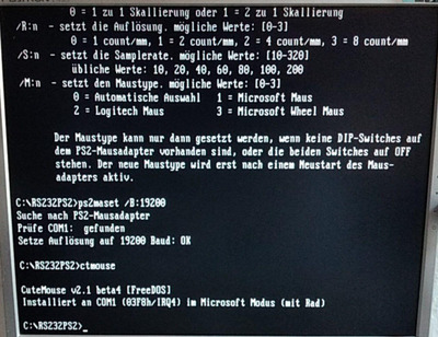

yes why not ? it works also with Windows 10. But only in 1200 Baud unless someone comes up with a patched Serial Mouse Driver for it.
I also used it already on Sun Ultra 10 on Solaris (Sparc Platform)
it works with Microsoft Mouse and Logitech Protocol.
There is Software to setup the Protocol and the Speed.

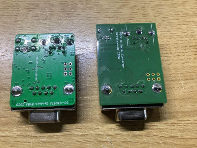

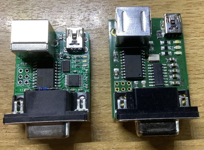

Reply 346 of 381, by matze79
212.17 KiB
1699 views
GPL-2.0-or-later
219.58 KiB
1699 views
GPL-2.0-or-later
A new Edition by Serdaco / Serdashop updated by Dreamblaster to even smaller Version.

Reply 351 of 381, by matze79
https://www.serdashop.com/PS2TOSERIAL
Official buyable now 😀
