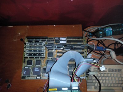

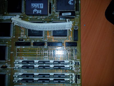

So I almost finished my 386 build. Still have a few issues to hammer out, but it runs and it's usable!
Configuration:
CPU: Intel 386DX 25MHz
Math Co-Procesor: Intel 387 25MHz
Mainboard: MORSE KP-386C-25 - no cache - expansion board for cache is missing.
RAM: 8x1MB Siemens single sided 30 pin simm
Drive Controller: Adaptec AHA 1542C ISA
Video Card: TSENG ET4000ax ISA 1MB VRAM
Sound Card: Creative Sound Blaster PRO 2.0 CT2600
HDD: Toshiba MK537FB 3,5" Full-Height 1,06GB SCSI Drive with 2MB cache
FDD: 3.5" Samsung 1.44MB and 5.25" Teac 1.2MB
CD-ROM: Sony 52x IDE (not yet working - see below)
Case: Baby-AT case with two digit display and 150W PSU.

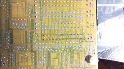

I picked up the motherboard from a guy who works at a recycling center, together with a Voodoo 2 and some other stuff. Most of it was damaged, including the 386 mb witch has some components missing (RTC Oscillator and corresponding capacitor). Despite that, the MB is functional. Battery hasn't leaked, and it now holds a charge (3.1v) and correctly stores CMOS information. Pics of the motherboard damage linked below.

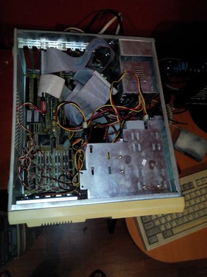

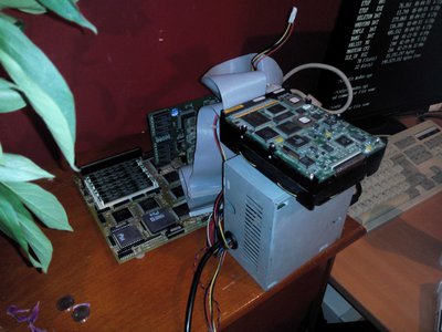

Here are some more pics of the testing and assembly process the machine went trough:

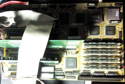

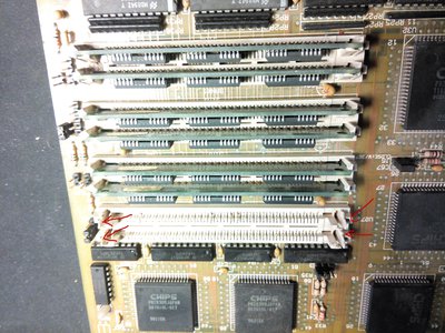

As you can see, two of the SIMM slots are broken - the clips securing the modules in place have been snapped off. Either someone tried to force the ram out, or it had something heavy stacked on top.
873.33 KiB
1624 views
992.43 KiB
1624 views
667.01 KiB
1624 views
^^ Notice the rubber band holding two of the SIMMs in place 😀 - could think no other way to fix it since the plastic clips are broken. ^^

I successful installed MS-DOS 6.22, Norton Commander and the CT2600 + dos drivers. No issues whatsoever.

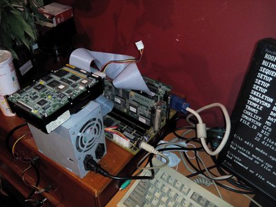

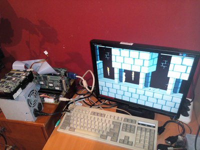

The SCSI HDD is off a 486 I got recently and it came with win95 installed and some other stuff. I could not boot into 95, the machine would hang.
I did boot into Command Prompt and ran Norton Commander and Prince of Persia witch were on it.

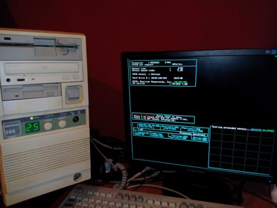

Speedsys hangs on "Year 2000 bug" detection, but I believe that is because of the non functional real time clock - however, when pushing the turbo button, the machine completes the speedsys CPU test successfully and scores a whopping 1.08! It seems the turbo button downclocks the CPU to 8MHz.

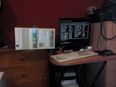

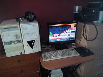

The gray teac 3.5" FDD doesn't work (won't read) so I had to replace it... I also replaced the fake FDD 3.5" bay cover. I don't like those for some reason.
828.59 KiB
1620 views
944.5 KiB
1620 views

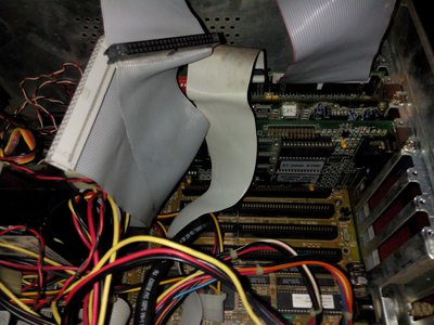

^^ Right next to it is my Pentium MMX / Voodoo 2 build. I used it to transfer stuff on the 386 via 1.44MB FDDs. You can imagine how long that took... ^^

3. The 5.25" FDD is not connected. I use the Adaptec SCSI controller for FDD because I have no working FDD / IDE controller and it apparently only supports one FDD. When I connect them both, the computer accesses them both at the same time and neither read. Does anyone know if it's possible to set up two FDDs on said AHA1542 controller?

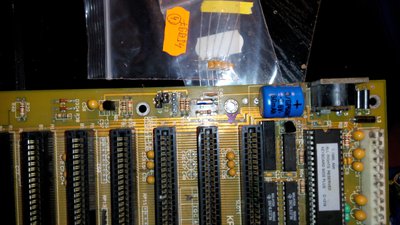

4. RTC doesn't count up and this causes Speedsys to crash. I'm not sure I will be able to install windows 3.1 on it either. Does anyone know the frequency for the small cylindrical RTC oscillator (marked Y1 like on many other boards)? What about the ceramic capacitor that goes with it? More about this (with pictures) here: Help identify 2 missing components on MORSE KP-386C 25MHz 386 maiboard

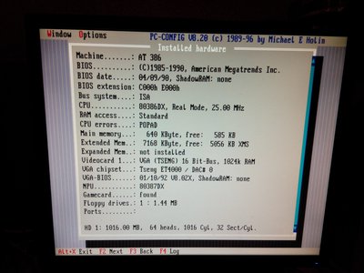

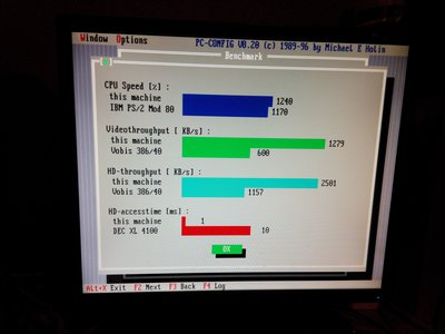

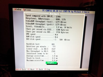

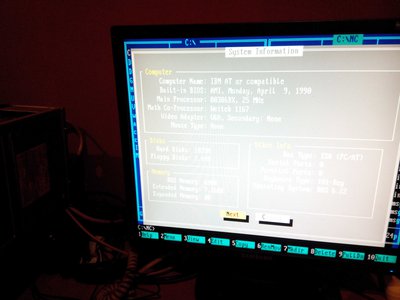

Here are some benches and system info readouts from PC-CONFIG (since speedsys hangs):

I finally got around to ordering the missing parts for the RTC - one 32.768 kHz crystal oscilator, one "104" ceramic capacitor and one 2ko resistor. Soldered them onto the motherboard and RTC now works correctly.
1.79 MiB
1354 views
Unable to find the manual for the motherboard, I ordered a new 3.6V barrel battery and replaced the dead one it came with. I tried an external battery but w/o a manual or jumper settings the MB would not store CMOS settings.
Also, the first two memory banks were damaged - the plastic retention clips were sheared off and I replaced them with 30-pin slots off a dead MB:
1.83 MiB
1354 views
The old socket did not survive the procedure.
1.19 MiB
1354 views
601.23 KiB
1354 views
Some of my nicest work 😁 and it only took a couple of hours.

Sure ? RTC - one 32MHz crystal oscilator
I'm sure a 32Khz Crystal is required.

I wrote MHz by mistake 😁 - the crystal I installed is a 32.768 kHz cylindrical crystal oscillator
