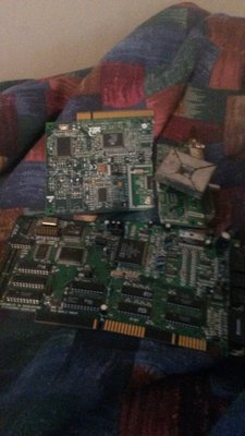

Hello! I discovered some hardware that would otherwise be considered very nice! This Media Vision Thunderboard and Voodoo TV 200 are special because of their owner history. In addition; I really enjoyed the microtuner on the Voodoo, and I would love to hear those two Thunder chips working together! Any help would be much appreciated! Thank you in advance.

That soundcard in the picture is not a Mediavision Thunderboard. Is it even Mediavision? It looks like a generic OPTi 929 card to me.
The voodoo TV 200 tuner is beyond repair unless you have access to alien nano-technology.

That's not a Thunder Board, looks more like an Analog Devices based 16 bit soundcard (that phone pic looks really bad as well 😵 ). Here is what a Media Vision Thunder Board looks like.
Unfortunately both the soundcard and Voodoo TV 200 are goners, unless someone knows an electronics repair wiz with real magical abilities and spells.

The two chips on the sound card are marked "Thunder". One has a darker color than the other. In addition; it seems to have the ability to emulate MPU-401 and Yamaha OPL3. How is it not a Thunderboard?

That's beyond any economic repair and at least 1 card identified incorrectly.
For one thing, the Thunderboard is an 8-bit ISA card as opposed to the 16-bit ISA card in the picture. I'm also fairly sure that no Thunderboard in existence used an Analog Devices chip, let alone an OPL3 chip (I *think* I can just make out an OPL3 chip in that blurry-as-heck picture). Instead, it used an OPL2 (a.k.a. YM3812) chip.

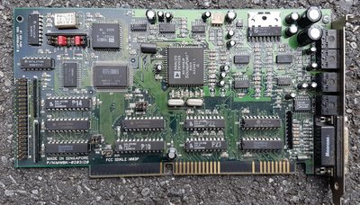

Hi there, I recently bought this card, which Richard seems to had.
Can anyone tell me anything about this card?
It does have an OPL3 and seems to have the Thunder Chipset, but it can't be a clone of the thunder board because of the OPL2?!
It's an ISA sound card with OPL3, the Thunder Board chipset and an ad1848jp chip ("Parallel-Port 16-Bit SoundPort Stereo Codec").
The ad1848jp supports Windows Sound System and other tasks, such as mixing, filtering, etc.

Yes, we said so. In contrast, my Protac TB clone card only has an OPL2.

I had some time to test the card a little.
First of all, the card seems to work.
I tried the tool above, it seems that the thunder board can be found. But something is wrong with the settings.
WSS works, SB Pro 2.0 with Warcraft 2, have to try more.
