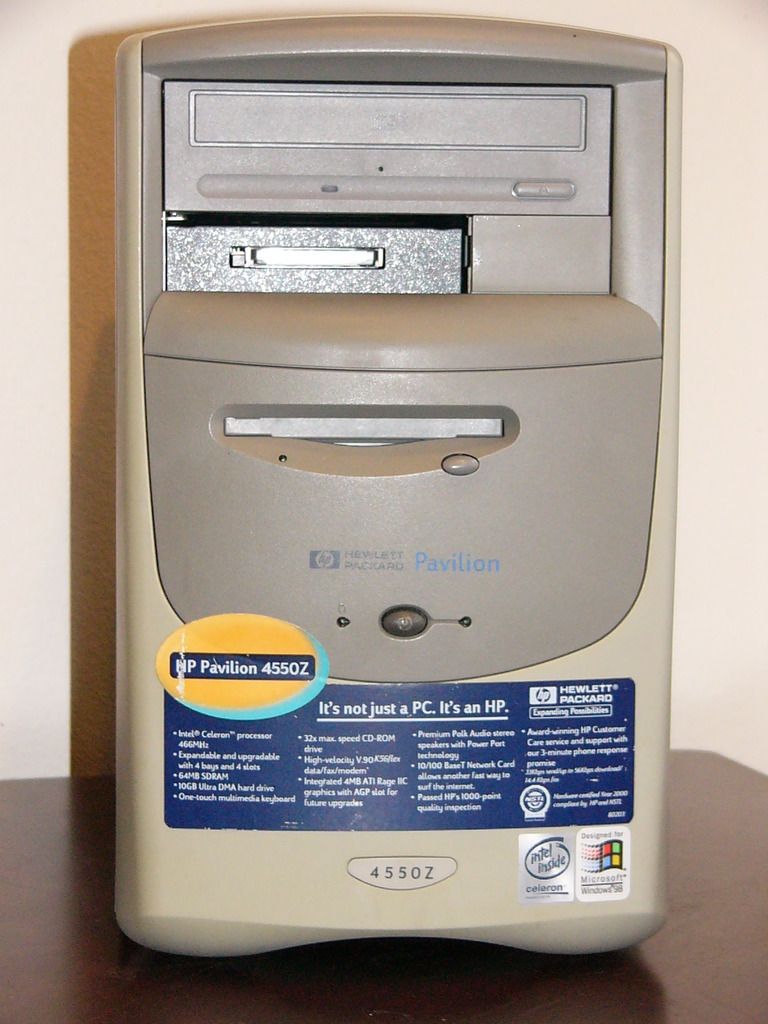

I have a bunch of the Hitachi microdrives that I use with a CF-to-IDE adapter. I like it quite a lot, actually. Like badmojo, I use an adapter that is front-facing so that I can easily swap out drives (like cartridges) without opening the case. I use it with a DOS/Win98SE OEM box (Celeron 466). One microdrive is my DOS drive with all of my AWE64 initialization routines in the autoexec/config as well as games such as Duke 3D, Doom, Blood, Descent, etc. Another microdrive is my Win98SE drive with games such as Quake 2, Unreal, etc.
If you look at the photo below, you'll see that the OEM Win98SE box came with a 10GB drive, so a 6GB microdrive is not such a big step down. You can always have multiples with the same OS and different games on them.
The drives are indeed slower than a typical 3.5" IDE drive, but I have not noticed any in-game stuttering or slowdowns.
I also use one in my DOS-only build. I use a modern PS (Corsair CX430), and the 486 DX2-50 does not have a fan (or heatsink!). Without a 3.5" IDE HD, this box is almost silent when running. I can barely tell that it is on.
One downside is that these drives seem quite fragile to me. I have had a least a couple of them outright die on me. They are pretty inexpensive, so it's no big deal, but you should always have a cloned backup.
Do you have a cheap source for those? All I can find are the StarTech units that sell for ~$30 each.
