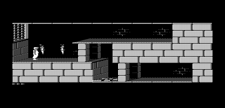

Reply 6 of 12, by konc
Thank you all for your suggestions, I found some time to give them a try.
It seems there is some issue here... First of all, both PC's I'm interested in are just XT clones, they don't have an original Hercules adapter. Still, every single native Hercules game works. They are both PC's I owned in the late 80's-early 90's and also back then I didn't run into any trouble running Hercules stuff. I did try "CAMERA" and "hercap10" as they are 2 utilities I wasn't aware of and really seemed promising. Basically they were the only ones actually "working" and thanks again for pointing them out.
So, why the quotes? This is what I get from both of them, no matter what I try to grab (command prompt, text mode app like Norton Commander, game):
1.89 KiB
961 views
I don't know what to think right now, it's not only one utility to take the blame. Maybe the adapter, not being an original Hercules, is the problem?

Reply 7 of 12, by Scali
If you get the proper graphics on screen, the adapter shouldn't be the problem. These old graphics cards are very simple: Whatever is in video memory, appears on your monitor. So, the capture utilities simply fail to copy the memory contents to a file.
I am not sure why this is happening... Perhaps because your card is MORE than just Hercules? Most clones I have seen, were combined CGA/Hercules cards. Perhaps the utilities are confused, and wrongly assume that it is a CGA card, and copy the wrong memory...
Because, as I understand, you always get the EXACT same image? No matter what you try to grab? That would mean that whatever memory it's grabbing from, is not changed when the contents of the screen change. So it simply grabs the wrong memory.

Now, are you ready for this? After seeing the code I thought to give it one more try. I started grabbing screens including a DOS prompt & Norton Commander (text mode). Ended up with something like 20 images after attempting ~15 games. From ALL of those, only Prince of Persia was grabbed correctly. This surpasses me…

Reply 11 of 12, by Scali
Well, that is interesting. So at least Prince of Persia does what you expect it to do.
Have you also tried to make it capture with page 1?
I wonder if it was common for games to configure page 1 instead of 0, because then the segment would be the same as their CGA code.
That is the only explanation I can think of why B000h doesn't contain any game graphics in most cases.
Reply 12 of 12, by Thandor
Good to see Prince of Persia in Hercules mode. Brings back memories 😀.
You can load HERCAP with parameter /1 to grab page 1 (and /0 for page 0). Using DOSBox I get correct files with page 0 for Prince (just like you) and empty files with page 1 (which seems right).
