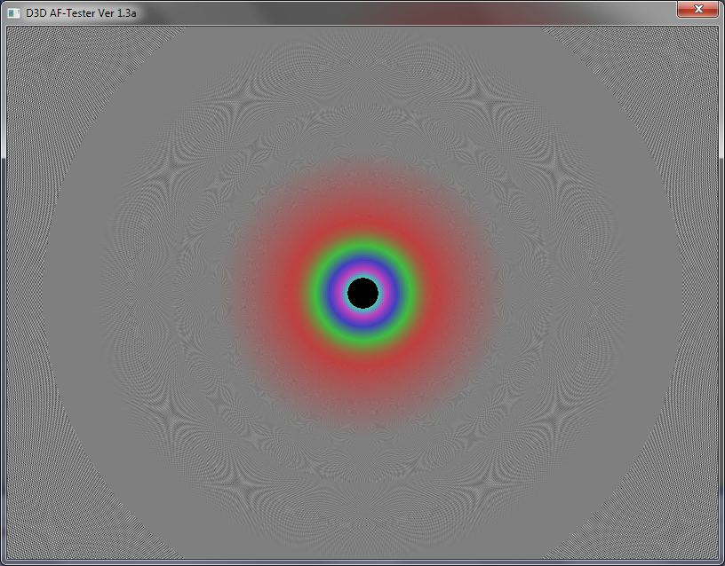

HD 5000 series (and later) Radeons indeed have angle-independent AF - but there is a visible line betveen the AF stages (the first one is clearly visible in D3D AF tester - depends on the settings).
In some games (depends on the texture type) this error is visible and it is really anoying.
Reply 14 of 27, by Putas
I cannot reproduce it on my Pitcairn card.
actually I see it now, enlarged via the forum- what is happening to images here?

Putas:
your screenshot is correct - the first AF stage border is there. Try to compare it with this one http://abload.de/img/beznzvu-1odujb.png
AMD have solved most of the AF problems of the HD 5000's on next generation. Radeon HD 6000 series and all CGN based (HD 7000 / 200 series / 300 series) are much better in image quality. Difference in AF tester is not that big but for most games AF defects are almost non-existent.
