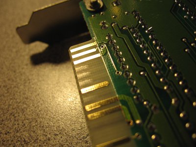

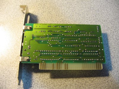

I received recently an AdLib clone that has a ton of interference.
Can't really figure out why though, as the usual suspects don't seem guilty this time.
Here's the link so you can listen for yourself :
https://www.youtube.com/watch?v=LaantYtsaMY
1. I tried checking if that card uses -5v, something that had given me much trouble in the past on a CT1350 when I didn't know about it. It does not (pin 5 on the underside not present)
2. I tried checking for bent pins on the underside, that could be touching other metal traces. A few were unbent manually. Still didn't do the trick.
3. I tried checking capacitors, but they are very small and I can't see any leaks or "expanded" tops.
4. I tried checking the 3.5mm connector, plugging fully, halfway, forcing sideways. Hum is always present.
5. I tried turning the potentiometer, and the hum increases/decreases accordingly. I'm assuming that the interference is present before the sound gets amplified.
6. I tried the card in another ISA slot, same result.
One small thing I noticed in the video, by the different sounds produced by the initialization of the floppy drives, is that one gives little to no interference (3.5" drive) and the other is clearly audible (5.25" drive).
Since only the 5.25" drive is connected to the 12v power, I'm assuming that the hum we're hearing is a 12v hum.
Curious, I looked at the 12v pins (both +12v and -12v) and noticed that the -12v pin is present (pin 7, image attached), but not connected to any trace leading to the board.
Anyone have ideas of where the hum could come from?

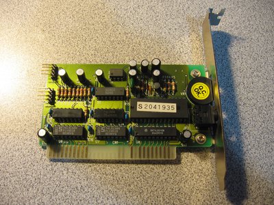

About the 4-pin connectors :
Looking at the traces, there seems to be a 4-pin input (likely for PC-Speaker or cd-rom) that goes through resistors, and a 4-pin output (like a line-out / pc-speaker out) that is connected directly to the output plug.
Using the PC Speaker output :
I tried plugging my PC Speaker to the output, and the adlib sounds play through the PC Speaker (only when there are no headphones/speakers connected to the card). Of note is the fact that the hum is still present and plays through the PC Speaker, though the speaker's bass response makes it more difficult to hear.
About using headphones :
The hum is present when using headphones, so we can exclude an external ground loop. Could there be something wrong with my computer/motherboard instead?
Floating inputs :
I tried grounding the PC Speaker in / CD IN pins, but the hum stays present.
Onboard chips :
I removed the label on the largest chip, revealing its true nature : it's more than a YM3812 (OPL2) clone. It has more pins. Attached is a picture of three examples... a true yamaha ym3812 (right), a reproduction of the ym3812 (center - KS8001) and our current mystery chip (left - SC801).
Grabbing the signal from the LM386 amp :
I understand what you want me to test, but I don't know where to make the second connection. To a ground I'm guessing?
Capacitors :
I have experience in changing capacitors in one of my computer monitors, and it's been 3 years and the little guy is still working. But if a capacitor is blown, to my limited knowledge, current stops going through it and thus, a blown capacitor would remove sound, not add it. I might be wrong though.

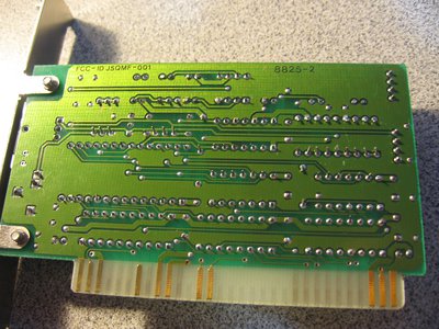

Attached is a better picture of the backside.
FCC ID is J5QMF-001 but I didn't manage to find pinouts or useful data apart from the company name : Princeton Technology Corp.

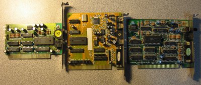

Curious facts :
I have two ISA slots on this motherboard.
Usually I only have one soundcard, leaving the other slot empty.
Since the interference in our current case is electrical, and not RF, I did a little experiment.
I chose a second soundcard to go in ISA slot#2.
Results :
Clone (slot#1) and 1990 AdLib (slot#2) electrical hum present.
Clone (slot#1) and Tolshine clone (slot#2) electrical hum present.
Clone (slot#1) and Sound Blaster CT1320 (slot#2) electrical hum almost disappears.
Clone (slot#1) and Sound Blaster CT1350 (slot#2) electrical hum almost disappears.
Any idea why that might be? Does this mean that my mobo/psu could be in the wrong?
