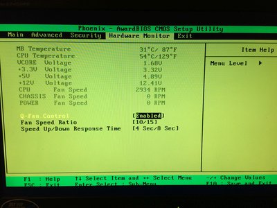

Voltages:
3.3V: 3.32V
5V: 4.89V
12V: 12.41V
MB temp: 31°C/87°F
CPU Temp: 54°C/129°F

oh my, i just found out that my VGA cable was doing the yellow color. I put in an AGP GF4 MX4000 and with that card the system is booting and POSTing flawlessly every single time. Also a voodoo 3 2000 PCI works. So now either both Geforce 4 Ti cards are faulty or the PSU isn't supplying enough power - what do you think?
