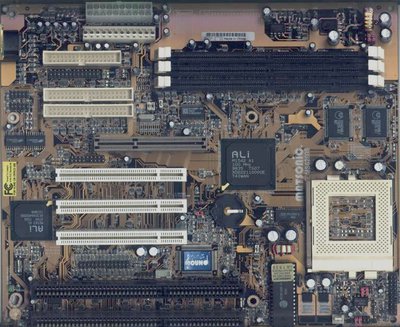

i have a good working Matsonic MS6260S BIOS (From 1999) but i need a newer BIOS or patched BIOS to recognize more then 32 GB IDE HDDs.
Had anyone the same Board or a patched Bios, that can i Flash on my BIOS-Chip, or can anyone apply the IDE Patch to my attached File ?
Here is my Board:

A sample Picture of the Board

Hi @ All,
thanks for the tips. I checked out that this Motherboard has a 32 GB Limit. All HDD´s above this put the Award Bios to Hang at IDE Initialisation.
Good idea to ask to J.Steunebrink to patch the BIOS 😀

Reply 10 of 23, by Dubinius
Greetings,
sorry for this very late Update of my Thread... Had do to something other and less Time...
So, here is the Status:
I spoke with J.Steunebrink and he tell me a very simple Information because he is not able to actually editing/modding AMI Bios Software but has no Problems with Award Editing 😀
First, undo the Clip Jumper (32 GB Limit). Just go straigt to the BIOS, disable Auto Detection and editing the Drive Specifications manually but this first Attempt don t work. I found a bug in my Bios when it goes over 40GB so i play around with my Cylinders to go nearly to this Limit and with this i can now set the full Capacity on the Disk with the Operating System 😀

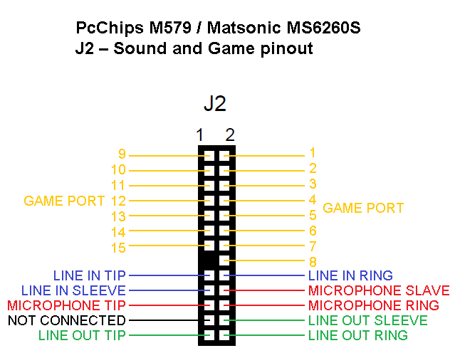

if someone has the original headers for J1 and J2, a pinout of those would be immensely helpful. It can even be approximative, e.g. USB connects to pins 1 to 8, PS2 connects to 9-12 and so on. Even some pictures would help, I think 😀
I have both the original headers but the J1 (for the USB; PS/2 mouse and IR) is not a simply header but a card with ribbon cable: "ATX Form Card" and it have two 10V 470μF capacitors for USBs and other components for all connectors. So althougs the first 8 pins of the J1 are the same as the most common USB pinout: http://www.frontx.com/cpx108_2p3.gif (except the "S-GND" is not connected) but with a normal USB header with this wiring will not work moreover can cause damages. I have attached images about my ATX Form Card. I thing PcChips have used this pinout/cards for same age and later AT form factor motherboards, because I see a later card with green PS/2 mouse connector (my one is "REV: 1.0" and all connectors are black), and you can still buy this card from some sites:
https://www.google.hu/search?tbm=isch&q=%22atx+form+card%22
J2 (C-Media CMI8330) header is an easier rebuildable thing. I have measured the pinout. Here are my results:

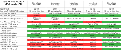

DeadMan274 wrote on 2019-03-19, 21:16:
Hey, Somebody has an old bios to the ms6260s board. From 1998s? With the BIOS 10/26 / 1999s I have big problems with the AGP. […]
Hey,
From 1998s?
Dubinius wrote on 2015-07-29, 21:52:
MATSONIC_MS6260S_BIOS.zip
This is the last one
quicknick wrote on 2019-03-19, 22:27:
MS6260S (Socket7, ALi M1542).rar
This is the oldest one
I got between bios versions - special thanks to edwin (www.elhvb.com). I have tested all of them, and there is no difference, all have problems with some nVidia cards.
Although I have succesfully installed on Win98 SE the GeForce2 GTS with Detonator 5.13 (4.12.01.0513) driver and GeForce 3 with Detonator 7.76 (4.12.01.0776).
Gona wrote on 2020-02-16, 12:25:
What the bios shows/writes at boot "AMD 500" is must be just a cosmetic problem only. My board with the same bios version shows/writes "Cyrix M II-350" but diagnostic program (AIDA16 v2.14) writes "PR433" which means my CPU is runs on the correct (the jumpered) speed.
I was wrong. Although the M II and K6-2 are only cosmetic problem, the K6-2+ and K6-III+ CPUs are works without problem with the latest bios version.
I have tested them:
17.88 KiB
832 views
I have succesfully used 512MB SDRAM modules in this motherboard (two of them so I can reach the maximum cached size: 1GB).
