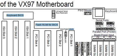

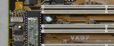

on the topic of first boards with USB:
here i see the Asus VX97 also has a usb header
what year is the vx97 from? one of the earliest Asus boards with a usb header that i know of
the chipset chips on the board are dated "95" that cant be right? can it?
maybe i should doublecheck the vx97 manual (the manual itself is dated january 1997!!)
the manual says literally nothing about the usb header but shows it in the diagram
I also saw the same exact USB HEADER on the Asus P/I-P55TVP4 Motherboard which shows an intel chipset dated 95
checking the manual for the P55TVP4 i see its dated december 1996!!
http://www.motherboards.org/files/manuals/1/p55tvp4-152.pdf
and it also uses a "VX" chipset
but of course those arent 486 socket 3 boards!!!!

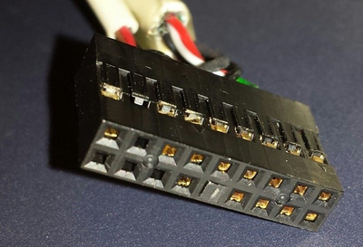

that usb/ps2/infrared port thing
someone did a sketch on it here
http://phorums.com.au/showthread.php?93097-AT … orm-Card-Sketch
detailing the 18 pin (2x9) layout of it

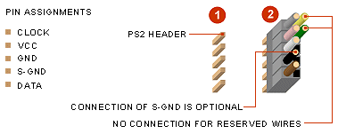

just found this pic of this 5pin usb header which differs from the 6 pin (4x2) header
is there a name for these different standards
so far im only seeing this on FIC motherboards? does anyone know any more info to contribute or share with me?
could it be that this 5 pin connection is actually for the keyboard and not the mouse? i hope not!

All my i430TX and i430VX boards have usb headers.
Even AT ones.
Beware that the header pinout was not standarised back then and you can easily burn a device or the motherboard controller.

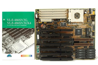

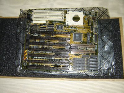

486 boards with no PCI slots!!!
VL/I-486SV2GX4
VL/I-486SV2G
ISA-486SV2 (some with VLB, some without)
with these i will have to buy new parts especially for it; which will only work with it;
ie: serial mouse, AT Case, ISA/VLB io Controller, ISA/VLB Graphic
all of these things wil be sold SEPERATELY by people on ebay because they are money hungry opportunists
mouse 20-25$
AT CASE 50$-100$
isa/vlb io controller 50$
isa/vlb graphics 50$
here im estimating an additional 225$ in costs NOT INCLUDING SHIPPING
and NOT INCLUDING THE PRICE OF THE FREAKING BOARD ITSELF
which can be put up to 200$ by gougers on eBay..
so the cost of this is up to 500$
im afraid im going to have to abandon this idea. theres no way im spending 500$ to build a 486 computer in 2015..
as much as i want to.
