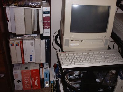

I think the CDROM that came with this machine is 2x speed, although I am not 100% sure. There are a few games that should work better with something a bit faster. I found a 8 x speed Mitsumi CD-ROM which I tried to attach last night. Unfortunately this CD-ROM was missing the cap for the jumpers at the back that select master/slave/cable select etc. I found a cap from a different drive and tried to use that, but it felt like it didn't fit well, so it may not have been doing the job. The original drive was set up as a slave so I tried that setting as well as cable select and also with no jumper but I could not get DOS to detect it. I think this machine used to allow access to the BIOS with a program that had to be on the original hard drive? That drive was replaced with an SD-Card when it died, so I don't have that any more. Would I need to change something in the BIOS? Just to be sure I am going to test the 8x speed on a more modern machine today to make sure it does actually work.

DEVICEHIGH=C:\CD-ROM\CD_IDE.SYS /D:MSCD001
I have an 8 speed drive in my CDS 524 running a 486DX2/66 and it doesn't require any slow down program. It is set up as a slave drive to a 2gig hdd. On systems this old I prefer to use cdrom drives without any speed rating on the tray. This system has become quite picky of late on what software will or wont run. Almost tempted to scrap it.
