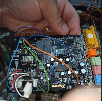

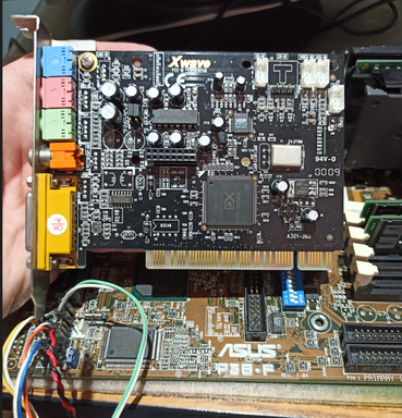

After googling and searching luckily I have stumbled on this post! I have the exact same Yamaha card I believe as the original OP of this thread.
My PIII rig specs:
Asus P3B-F v1.04 440BX slot 1 [[this is the 2x ISAs variant]
512MB RAM
**Intel PIII 500Mhz Katmai
Voodoo 3 2000 PCI
Nvidia GeForce 4200 TI 128MB AGP
Windows 98SE and MS-DOS 6.22 onto 2x SD2IDE adapter cards to switch between these.

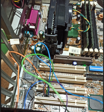

Had the Creative 64 AWE value CT4520 but due to I'm not happy with how it sounds I decided to remove it completely and jump on to this SB-Link bandwagon and tempting to use just the Yamaha card alone.
Yesterday I have just soldered pin headers to the mobo for the SB-Link and tested some games under Windows98 restarted in DOS mode using Phils MS-DOS starter pack.
Please excuse my questions here, as I come from the Amiga world era, and most of the stuff is new to me.

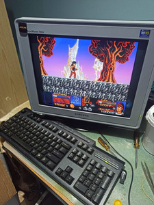

Games tested;
Oscar in which I had issues of no in game music when I had both Creative and Yamaha installed together, now OK.
Soccer Kid: this I had no success due to no sound and no sfx, even when I choose both in it's setup. [But checking this post here, it might be that I was always running the command "setupds" and never did run the "setupds /s"]
Doofus: OK
Death Rally: This one is tricky to run, or it launches without any sound or launches with sound but stops after few seconds after the "G Interplay" screen. Seems this is a difficult one to run, there are many posts about it and others suggested to try the Windows version instead [no network version]

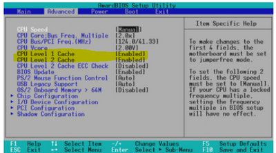

**Regarding the Asus mobo and PIII 500Mhz, what is the most efficient way to slow it down ?
What I have tried so far is;
Changing the speed of CPU from BIOS from 500Mhz to 333Mhz in the BIOS
I have also tried disabling both CPU level 1 and level 2 cache from BIOS, am I doing correct ?
Thanks in advance!

So today I have installed a multi USB 2.0 PCI adapter (VIA chipset) in which I had to change and fiddle with IRQ settings due to BSODs.. Anyway managed to get it running and sharing some experiments and results..
CPU speed reverted back to 500Mhz.
All these launched under Windows98SE restarted in MS-DOS mode with Phil's MS-DOS starter pack (option 4- expanded memory plus mouse support)
Games tested so far:
Oscar
Death Rally
Doofus
All above games were launched under Launchbox MS-DOS special edition front-end (this makes it a lot easier for me due to like I mentioned I used to have an Amiga back in the day).

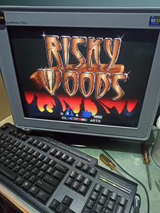

OK,
So anyone did try the game called "Risky Woods" by EA [1992] ?
Unfortunately I cannot get music in this one... I am trying to find the actual manual
