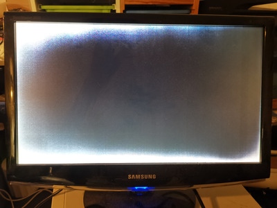

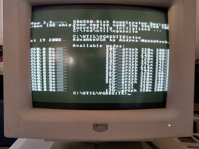

Monitor:    Samsung 2033SW
Native res: 1600x900
Scaling: Unknown
Aspect rto: 16:9
Machine: 486DX/50, DOS 6.22
Video card: 2theMax ET4000 W32i
UniVBE: N/A
Tested by: Brassic Gamer
OVERALL COMPATIBILITY RATING:
9.5/14 - Not bad at all for a wide, cheap panel.
Application P F CP Notes
| Ambience | | X | | Messed up screen (pic) |
| Luminati | | X | | "Not Optimum Mode" |
| Timeless (56Hz) | X | | | |
| Timeless (60Hz) | X | | | |
| Dowhackado | X | | | |
| Kukoo2 | X | | | |
| Copper | | X | | No wobble at all. |
| Sunflower | X | | | |
| Yo | X | | | |
| Impulse Tracker | X | | | |
| CubicPlayer 132x43 | | | X | Bad scaling. |
| Tweak 256x256 | | | X | Didn't display the bottom 16 pixels. |
| Tweak 360x480 | X | | | |
| Tweak 376x564 | X | | | |
| PAL-on-VGA | | X | | "Not Optimum Mode" |
| NTSC-on-VGA | | X | | "Not Optimum Mode" |
| Other notes: |

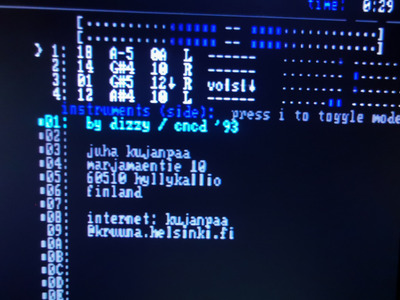

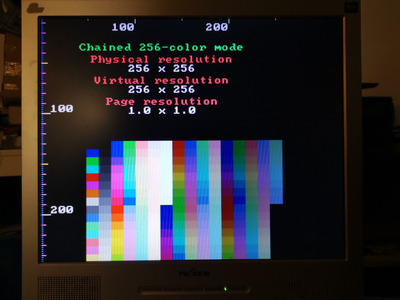

Monitor:    Proview MA-782KC
Native res: 1280x1024
Scaling: Unknown
Aspect rto: 4:3
UniVBE: N/A
8/14 - A limited panel.
| Ambience | | X | | "Mode Not Supported" |
| Luminati | | X | | "Mode Not Supported" |
| Timeless (56Hz) | X | | | Letterboxed |
| Timeless (60Hz) | X | | | Letterboxed |
| Kukoo2 | | X | | "Mode Not Supported" |
| Copper | | X | | No wobble. |
| Yo | X | | | |
| CubicPlayer 132x43 | | | X | Bad scaling (pic). |
| Tweak 256x256 | | | X | Top 6, bottom 8 pixels not shown, large |
| | | | | gap displayed on right of screen after |
| | | | | automatic adjustment (pic). |
| Tweak 376x564 | X | | | Letterboxed slightly |
| PAL-on-VGA | | X | | "Mode Not Supported" |
| NTSC-on-VGA | | X | | "Mode Not Supported" |
| Other notes: |

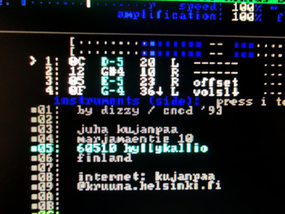

Monitor:    Ambra AWS2500
Native res: 1024x768
Scaling: N/A
Aspect rto: 4:3
UniVBE: N/A
14/14 - Almost flawless.
| Ambience | X | | | |
| Luminati | X | | | |
| Kukoo2 | X | | | |
| Copper | | | X | Great wobbling, couldn't do all sequences. |
| Yo | X | | | |
| CubicPlayer 132x43 | X | | | |
| Tweak 256x256 | | | X | Vertical letterbox, adjustment required. |
| Tweak 376x564 | X | | | Adjustment required. |
| PAL-on-VGA | | | X | Displays, but with ghosted image. |
| NTSC-on-VGA | | | X | As above |
| Other notes: tried images using SEA and it could display the 1280x1024 JPG |
| but not the GIF. |

| CubicPlayer 132x43 | X | | | Text not very sharp |
