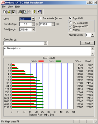

Reply 14 of 15, by PhilsComputerLab
Rank Hardware Mod
Hardware Mod
Might be time to switch to SD cards. Tried out a few adapters and they work fine. Local super market sells no name 16 GB and Verbatim 8 GB SD cards, both work fine, the Verbatim performs faster though.
Attached is a benchmark, run on a P4 with XP live and ATTO. In POST, the adapter shows up as a UDMA6 device.
The low size write performance is certainly decent, I wouldn't have issues recommending it even for a Windows 98 SE machine.
Compared to the CF cards I have, the SD has lower read performance, but better write performance, more important IMO.
