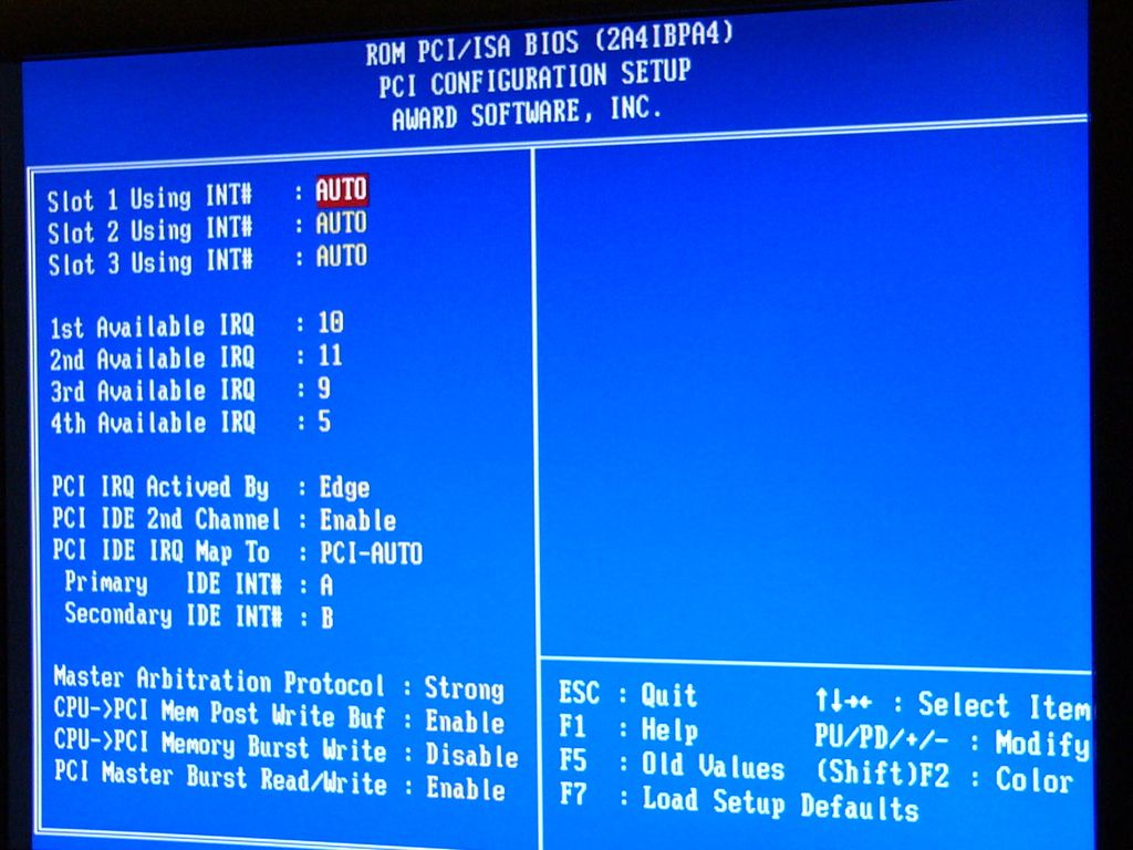

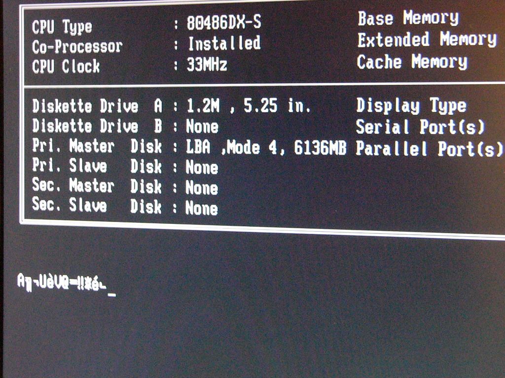

I'm bench testing a 486 motherboard, a Green GXA486SPM. Here is a link to the manual: http://www.elhvb.com/mobokive/archive/epox/ma … uals/486spm.pdf
I am using a CF-to-IDE adapter with a 6GB Hitachi Microdrive. I used FDISK to create a 2GB partition.
I was able to successfully install MS-DOS 6.0 off 5.25" floppies, but when the computer rebooted at the end of installation, I saw the screen in the first photo. No "Starting MS-DOS," just garbage characters. The system just hangs.

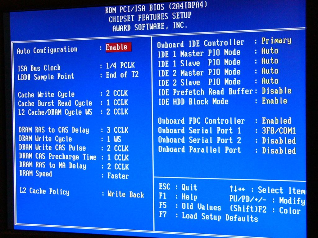

The MS-DOS install went smoothly, so the HDD was running just fine then. When I boot off a floppy, I can go to the C: drive and see all the files. I've included a few photos from the BIOS screens.
Any ideas what might be going on?

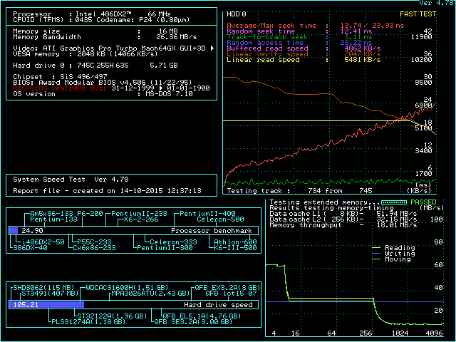

How useful is Speedsys' HDD test? I'm not sure which other bench to try.

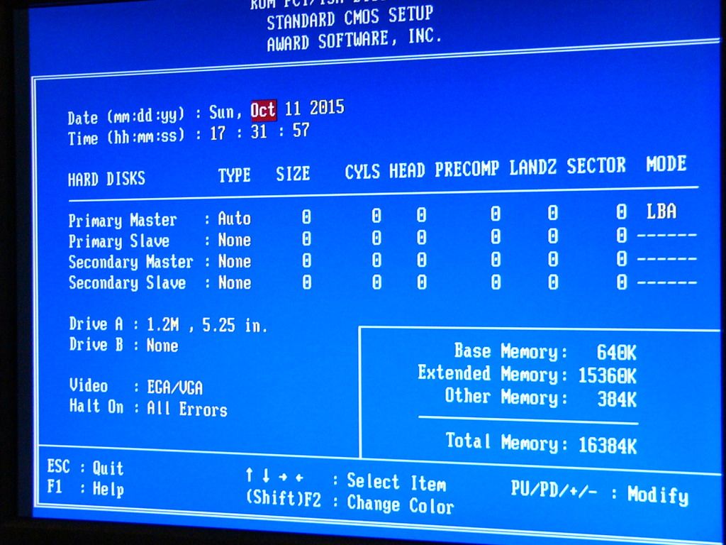

Couldn't get the CF card to work. Fresh from the package, I was able to boot off the A: drive and perform FDISK. I had to delete a non-DOS partition and then created a new 2GB partition. However, when I rebooted, the system hung right after the BIOS recognized the CF drive (correctly, as a SanDisk model). Not sure what happened. I can't even boot off the A: drive to do a format. Everything is fine when I put the Microdrive back.

Reply 14 of 15, by boxpressed
alexanrs wrote:
What happens if you go to the BIOS and manually specify a geometry? Of it you just set it to disabled?
That was it, thanks. Can't believe I didn't try to enter the geometry manually. It just worked automatically for the Microdrive, so I thought it would do the same for the CF card.
Speedsys reports a hard drive speed of 1183.02 (compared to the 105.21 for the Microdrive).
