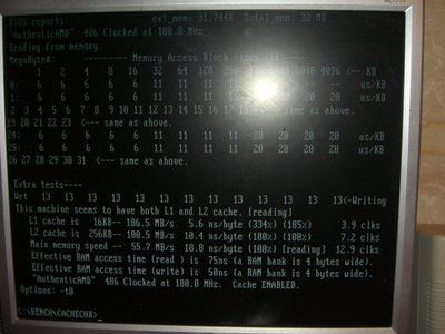

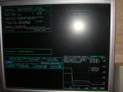

Now Im getting somewhere! 😀
I tested the "new" Lucky Star LS486E C1 motherboard to see what it could do, 60 MHz seems to work well in DOS at least. The LS486E isnt as fast clock for clock as the MG V1.1A (M921 clone) but at 180 MHz it gets some decent scores.
AMD 5x86 3x60 MHz Speedsys.

AMD 5x86 3x60 MHz Cachechk.

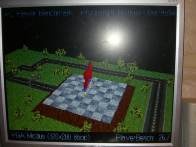

AMD 5x86 3x60 MHz PCPbench VGA mode: 26.7 FPS

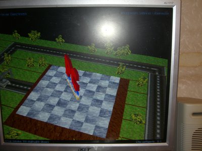

AMD 5x86 3x60 MHz PCPbench Mode 100: 11.3 FPS
