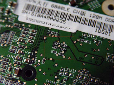

Reply 16 of 17, by kanecvr
There are a few threads witch describe the 6800le / nu to 6800 ultra resistor mod - unfortunately the much needed pictures of the resistors one needs to bridge are gone. I could not find pictures in any of the topic-related threads 🙁 This should have been preserved in places like Vogons for future reference.
I'm not sure measuring EVERY resistor on the back of the boards is feasible...
Reply 17 of 17, by kokornov
https://web.archive.org/web/20041209150122/ht … temReview&no=39
here's some pictures
UPD: tried that on Leadtek A400 LE. Didn't work for me. RivaTuner still shows 8/4 PS/VS even after flashing non-LE bios. Though you can permanently unlock units by applying NV4xBIOSSwUnitsMaskEliminator script to video bios from RivaTuner. I was only able to reach 6800 non-LE formula (12/5), volt modding to 1.4v didn't help against artifacts.
