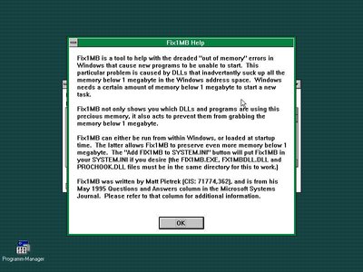

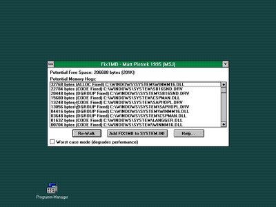

Gahhhrrrlic wrote:
Do you know how to use Fix1MB? I can't get it to work. Does it need to reside in a specific folder before I run it? Do I need to run it from a dos shell?
Um, I simply copied it to %windir%\system and ran fix1mb.exe in Windows.
It also has got the ability to configure system.ini accordingly, so it autostarts.

Reply 44 of 77, by Gahhhrrrlic
Jo22 wrote:
I don't think it works on WFW. I put it in the system directory and it just does nothing when I click the exe file.

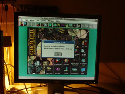

Ok. So I installed GME 95 (v7.04) on my Pentium 133 (GA586S mainboard) wit 32MiB RAM and S3 ViRGE graphics.
OS was Windows 3.10 on DOS 7.0 (Win95 DOS). Default settings were used, except the addition of VIDE-CDD.SYS+MSCDEX, Mouse and Keyboard drivers.
The video is available here: https://youtu.be/0EBRedYuY4U
Along the way, I encountered some read issue with my CD-ROM drive and got a "low memory" warning in GME95.
After running MemMaker, things got better and I was able to select some topics from the menu.
With the exception of videos.
I will try that another time again. maybe with the help of QEMM, 386Max or that Helix package.

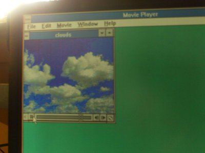

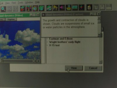

Update. Installed QEMM 7.04 and did some further testing. I also loaded Fix1MB..
Well, things didn't come out as expected. The programs still yammers about little memory.
I also changed graphics drivers (VGA and native ViRGE 325 drivers), left a high amount of UMBs left, but no chance.
Edit: I ran OPTIMIZE /NODOSUP since DOSUP doesn't like DOS 7 very much. I also used STEALTH mode later on.
On Win95, however, the program runs fine. Makes me wonder if it was designed with Win95 in mind.
Quicktime (16-Bit) runs "fine" on both OSes, by the way.
Still need to figure out what's wrong (out of GDI resources ?) - I'll see what I can do.
