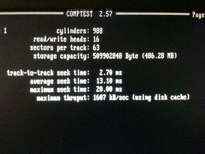

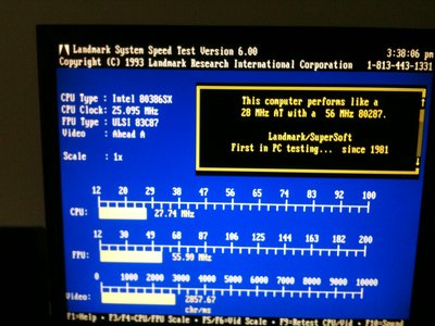

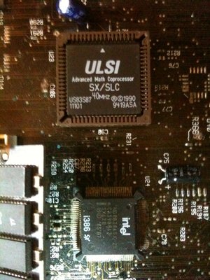

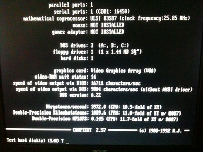

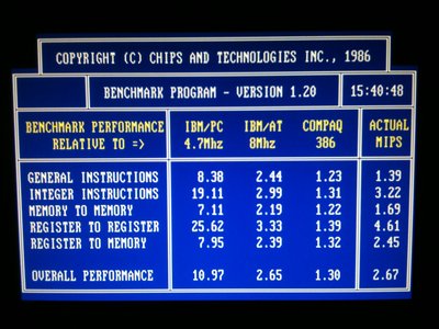

ULSI 387sx FPU arrived and installed. BIOS detect it is there just fine too.
Added the file COMPTEST 2.57(a nice old diag tool) as referenced by the author of the facinating document that elianda linked to above. Couple of others too, MIPS from Chips & technology from 1986 & good old landmark.
now to find something useful for the co-pro to accually do! 🤣

Here are my results with the FPU and vintage Conner HD.

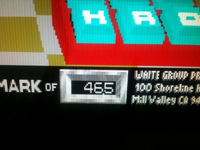

OK, this is pretty weird, this seems a VERY high score for 3D Bench and this system, It's repeatable, have done it over a dozen times in the last few days always within a few points, this is as quick as many faster 486 and even Pentium 60/66 systems! Anyone know what is going on here? I have also run all the champ games, asterocks, galagon etc and they work full speed too despite being supposed to need a 486/33. My buddy played Asterocks on it last night and could tell no difference than on his UMC 486S 40MHz with a VLB S3 805 system.
Have added my scores here to the database: https://docs.google.com/spreadsheets/d/1lvF9n … wpNU/edit#gid=0 it's right at the bottom of the sheet right now. All the other scores, DOOM, QUAKE etc seem comparable to the other low clocked 386 machines on there. I mean this score is only 10 points less than my entry with a Winchip 200 & WD Paradise ISA card! What on earth is going on here???

Hi Chris,
What you are having over there is the board for an IBM PS/1 2133 or 2155 (depends on the riser) from the Fall 1992 series. It came in 3 versions with 2mb-RAM+256kb- VRAM, 2mb-RAM+512kb-VRAM and 4mb-RAM+512kb-VRAM. I have such a system that I'm doing my best to restore.
There are a few notes:
1) No hard-drives larger than 1024 sectors with that particular BIOS release unless you run a 32-bit OS, which brings me to:
2) No Linux/Windows NT/Solaris booting unless you boot the kernel from a diskette after running UNIXBOOT.COM. It has the fixed drive parameter table at a different location than the original AT computers and most OSs don't understand that. UNIXBOOT fixes it.
3) No 32-bit disk access in Windows 3.1 unless you use a special driver that you can find in the IBM PCBBS archives (never bothered to try it though)
4) No ATi Mach64 cards on it because they need I/O Port 0x10? which is used by the Programable Option Select hardware on the Motherboard. The EXM281 (Graphics Pro Turbo) card that I'm having boots wonderfully on other systems but not on this one.
5) If you use a sound-blaster card or a 3Com card make sure that they are in PnP mode and that you have a DOS PnP Manager (like the Intel one). Even optical drives work if you do that.
I also have the original software included on it and the original service manual is "63g2028.PDF" which you can locate on Google. I am working to source a newer BIOS version that does not have the odd IDE FDPT problem and can solve points 1 through 3 for you.

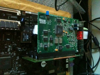

Installed my Microsoft Windows Sound system ISA card along with Windows 3.11 for Workgroups, Afterdark & Microsoft Arcade yesterday.
1.31 MiB
1101 views
Been playing Microsoft Arcade's, Missile Command and Asteroids loads, they run spot on but Centipede is rather slow.
Also played some INDY 500, LOTUS III & PC*BERT DOS games, all running great.
Been having a lot of fun with this machine, just really need to find a case of some sort. Am i right in thinking this is LPX?

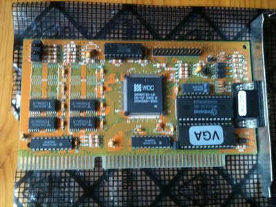

Might try out these two ISA VGA cards later, a Pine Western Digital Paradise WD90C30LR 512K & a Pine Realtek RTG3105iEH 256K. I know when I tested both on my socket 7 machine that the Paradise did pretty well but the REALTEK was incredibly slow.
Will be a bit of fun playing with them anyway 😀
