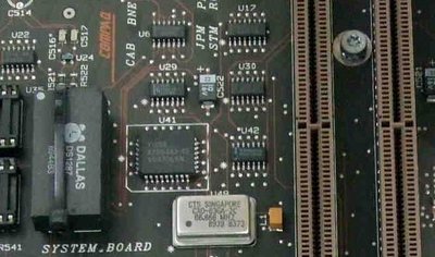

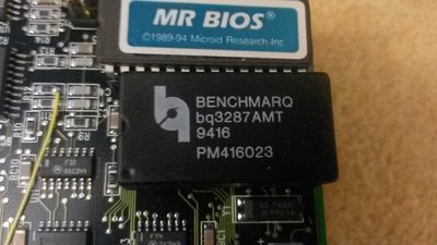

About to embark soon on replacing a few RTC's on some old motherboards, in an attempt to get them working again.
For now though, I can't seem to find an clear answer online regarding what would happen if I remove an RTC from one 'working' system to swap with an identical RTC on a 'non-working' system?
Would this have consequences for the working system when I put the RTC back into it? Loss of CMOS data relevant to that board causing problems to boot?
Thanks

Reply 1 of 6, by Malvineous
Nearly all boards have a 'reset CMOS' jumper to wipe the RTC, and still other boards have had the contents lost when the battery goes flat. It doesn't cause any harm, unless you have an old hard drive that needs manual BIOS settings, in which case you only have to put the same settings in or you might have to reformat the drive.
If you're swapping RTCs, it's probably a good idea to either reset the CMOS using the jumper, or at least go into the BIOS setup and load the defaults after putting the new RTC in, just to avoid the potential situation where the old and new BIOSes use the same checksum, and the new BIOS accepts the existing RTC values, which aren't valid for the motherboard.
Unlikely to cause major issues, but if there are things in there like CPU multipliers then you may not be able to boot until they are reset, and the BIOS reset jumper on the motherboard is probably the best way to do that.
Remember that the BIOS reset works by putting a jumper on it, powering up the system, it won't POST, power it down again, then remove the jumper. If you just connect the jumper without powering up the system, it won't erase the RTC.
Reply 2 of 6, by feipoa
You will surely want to "clear CMOS Data" upon transplantation of the new RTC. The orginisation of the BIOS on the old MB will likely be different to that of the new MB. Keep in mind that if you are using a Dallas 12887, the versions without the 'A' suffix do not have a jumper option to reset the CMOS.
Reply 3 of 6, by 386_junkie
Cheers guys.
I wasn't sure about the stored settings and the effect it might have being put into another system... but if I can clear the CMOS, swap RTC's to test, clear CMOS, and swap back to initial settings... then that's great.
These Benchmark versions with the 'AMT' suffix are apparently compatible with the Dallas 12887's that have the 'A' suffix... so I should be ok to go ahead and switch them for testing.
I just hope the non-working system will now work... and after switching them back, the working system will continue to work, as if nothing ever happened.
