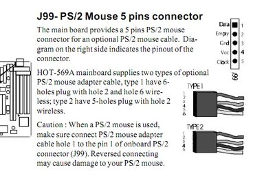

Greetings. If possible, I would please like someone more knowledgeable to confirm that the following is the correct pinout for the PS/2 port header (J99) on a Shuttle HOT-569A motherboard:
1 - Data
2 - Not Connected
3 - Ground
4 - Vcc
5 - Clock
Typically I'm very good at eventually finding out info like this, but I'm asking here because the single solitary Google entry I can find with the info I need leads to a site that is no longer working (https://oerg866.titandemo.de/drivers.mdscene. … 71/571_569_.pdf), and Google does not have a cached copy of it. The little search result snippet for the page lists the pinout above, but without seeing the entire page I cannot be 100% certain that is the info for J99 and not some other random 5-pin header on the board (Depending on how the text is laid out, an indexer/bot will often read PDF files out of order).
Whatever the actual pinout, the next step will be finding (or modifying) a PS/2 bracket for use with this board. But, that'll be for another time.
Thank you. 😊
Reply 1 of 3, by PCBONEZ
61.92 KiB
411 views
Shuttle Hot 569A - J99
