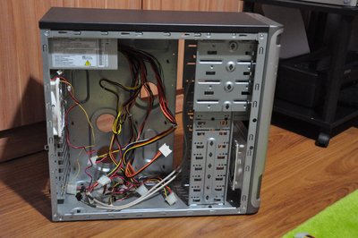

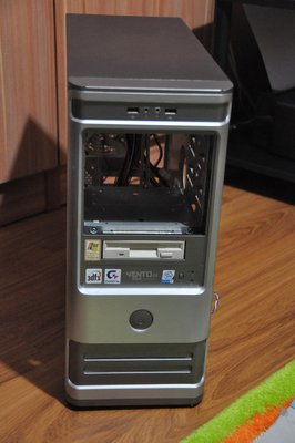

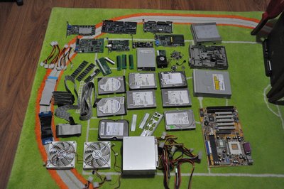

While waiting for the parts to arrive, I completely disassembled the old PIII. Can you believe that much stuff coming out from a single ordinary mid tower case? 😊
576.96 KiB
1865 views
Here is the afore mentioned case:
197.47 KiB
1858 views
466.15 KiB
1858 views
PSU is a good old ATX AOpen 300W unit with -5V. I will probably change it in the near future with a more modern mid range PSU like Thermaltake TR2-500 or similar. The (very) high cfm Silverstone fans will be changed as soon as possible, though; they sound like a C-130 Hercules. 🤣

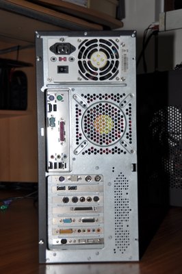

Reply 13 of 19, by tayyare
It apparently took about 2.5 years but finally it's complete and working. Yay! 🤣
It was very frustrating from time to time, but on and off, I finally make it work. Final configuration is like this:
Intel D865PERL mainboard (version with 100Mbit LAN, simpler onboard sound, no RAID and no firewire)
Intel Pentium 4 3.0GHz Prescott SL7KB CPU
Kingston 1GB x 4 DDR400 RAM
Matrox Mystique 220 4MB PCI display adapter with Rainbow Runner upgrade kit
ATI All-In-Wonder 9600 Pro 128MB AGP display adapter
Sound Blaster Live! SB0060 sound card with LiveDrive II and additional connector brackets
Adapted AHA-29160N PCI SCSI controller
Generic NEC Firewire I/O card
2 x Maxtor Diamondmax 10 200GB IDE HDD drives
2 x Maxtor Diamondmax 10 200GB SATA HDD drives
Mitsumi 3.5" 1.44MB floppy drive
LG GSA4040B IDE DVD-RW drive
TSST SD-R5372 IDE DVD-RW drive
Aopen FSP300-60ATV 300W power supply
Asus Vento TA-D5 chassis
2 x Thermaltake 120mm A2492 case fans
Intel stock CPU cooler
It's a multiboot machine with two instances of Windows 98 (one for ATI, the other for Matrox), Windows XP and Windows 2000 (not installed yet) all in their own HDDs (hence four of them). The boot procedure is somewhat awkward since it requires you to go into BIOS and choose the primary display card (PCI/AGP), drive operation mode (legacy/enhanced), and boot drive, each time you want to boot a different OS. SCSI card is there for a SCSI HDD drive for ghost images and other backup files like OS setup and drivers. Unfortunately, I run out of my stash of 140GB SCSI drives, so I'm looking for a new one.
For the sound card, my intention was using the existing Audigy LS, but sometime ago I scored a SB0060 complete with all the brackets and a LiveDrive II so I used it instead.
116.13 KiB
1596 views

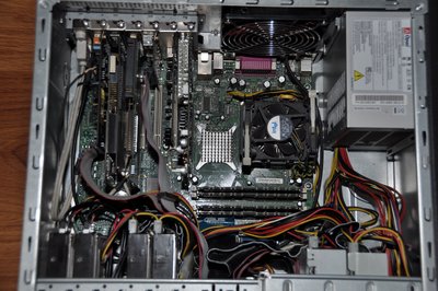

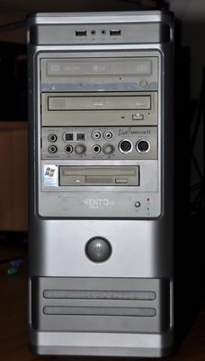

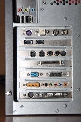

Finally, here are some pictures:
299.02 KiB
1596 views
392.64 KiB
1596 views
567.25 KiB
1596 views
I'm not any good at cable management 🤣
429.04 KiB
1596 views
Last bracket is custom made, SB Digital DIN Bracket and USB bracket combined.

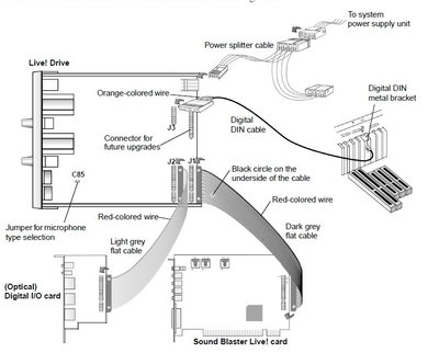

I guess the "full support" is if you use raid (if this motherboard has it) I was surprised how well the Win98 drivers worked with my Asus P4P800.
and boy that's a lot of stuff hanging off the live drive. I like how you have to run a cable from the soundcard to the livedrive, then a bunch back down again. at least a din connector on the soundcard would have been nice creative!

On the LiveDrive, there is another connector for "future upgrades". Apparently, they were thinking about adding even more cables and brackets 🤣
