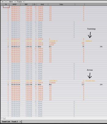

No, the SC-VA does not support Fallback to Capital.
Attached is a recording of the events from World of Xeen.
When I walk the game calls for all controllers reset (121) and wheel reset across all channels, then it changes controller 0 to select variation 5,
then calls for patch Applause which should result in a Footstep; Exactly like it explained in the SC-55 manual to properly change to a GS variation.
When I fire an arrow the game calls for Controller 0 variation 5 patch Acoustic Bass.
According to the manual these is no variation 5 of Acoustic Bass therefor I hear another Footstep when I shoot an arrow.
To me it seems that the developers of Xeen simply ignored the integer in the variation spot when changing to a patch that does not need it.
So this integer in the variation/bank spot simply was sent with the previous value it had in it.
We don't need it, so we simply send whatever is still in it.... 😕 😒 😐 😢
Man, a single spared line of code in 1993 causes so much pain and suffering in 2016... why god WHY!!!! you lazy bums!!!
If you ask me, there is no such thing as "Fallback to Capital" feature as we call it now, it's simply lousy programming that worked for the developers for the particular hardware they had, and they never looked back.
MMaximus, "Fallback to Capital" thing is just lazy or mistaken programming and nothing else.
The SC-55 clearly states how to properly change variations and patches, nowhere I've seen statement like "If you switch to capital patch you can ignore controller 0".
On the contrary, the manual specifically states "Send the messages in the following order when creating the MIDI messages with a sequencer or a personal computer"
I imagine personal computer includes games...
Right there on page 46: http://cdn.roland.com/assets/media/pdf/SC-55MKII_OM.pdf
All in good spirit and humor of course. 😀
