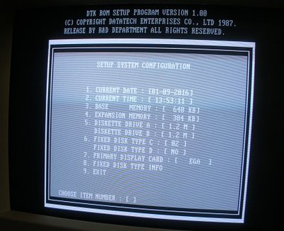

I have a DTK 286 board here I'm trying to get running. The BIOS setup doesn't give a choice of floppy drives installed like most other BIOSes i've used, but automatically detects them, though unfortunately not correctly.
The 3.5" 1.44Mb floppy drive is detected as a 5.25" 1.2Mb drive, it still works though but only with double density 720k disks, HD 1.44Mb disks usually hang the machine of gives a read error.
Has anyone ever encountered anything like this before?

I've never seen a 286 that automatically detected drives that that before.
The first thing I'd do is try a generic BIOS setup called "gsetup", and see if you can set the drives manually.
If you can determine the type of chipset on your motherboard, you might be able to download a BIOS replacement and program some new ROMs. DTK BIOSes are generally regarded as crap anyway.
I replaced the IBM BIOS in my AT 5170 with a generic AMI BIOS mainly to get BIOS support for 1.44meg drives.
Reply 2 of 24, by Scali
I don't think there *is* a way to autodetect what type of floppy drive is connected (you can detect if a drive is present or not, but that's it).
I've not seen it on any of my systems, and I wouldn't know how the floppy interface would even make it physically possible to detect.
IDE is different, you can send commands to the harddisk controller on the drive, and it can send back the drive geometry. Floppy drives don't have this.
So there has to be a way to configure the drives manually. Perhaps there are jumpers on the motherboard/IO card for this, if your BIOS setup doesn't allow you to change them?

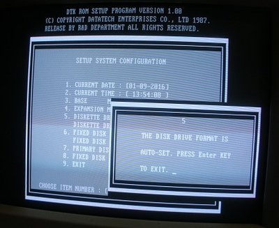

Reply 3 of 24, by GoblinUpTheRoad
Looking at the pic in the first post, if you choose item 5, this screen pops up ->
52.42 KiB
1377 views
Then any key you press exits back to the menu.

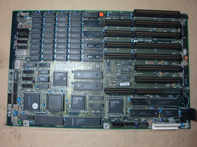

Can you post a high resolution image of your motherboard? If you want a replacement BIOS you are going to have to make sure it matches whatever CHIPS chipset your happen to be using. CHIPS was pretty common on 286 boards, so the odds of finding a phoenix, award or AMI 286 BIOS are pretty high.
Reply 5 of 24, by GoblinUpTheRoad
1.34 MiB
1348 views
The "CHIPS" chips are P82C201, P82C202, P82A203, P82A204, and P82A205.
The board has a jumper setting for 27128 and 27256 ROMs so either size can be used, the DTK ones are 128s.

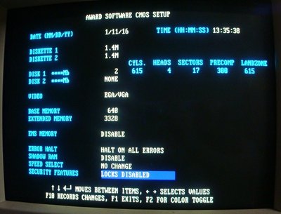

I tried a ROM set found here, http://chukaev.ru54.com/bios_en.htm#z2zzw001 z2zzw001, an award BIOS for a winbond board, as it had 83C201 - 205 listed for the chipset, and it mostly worked OK. I can choose any drive type I want in this bios, and could read HD disks successfully once it booted up. The only issue was the keyboard would become unresponsive after a few minutes, mouse would still move and programs kept running, but no keys working.
80.4 KiB
1231 views
Might try a few other random BIOSes later on, but I'm back to work tomorrow so won't have as much time.
