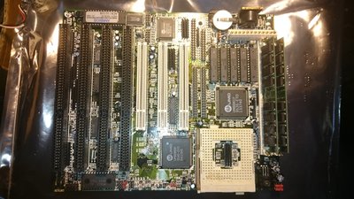

... Seems to be unbranded. I can't get it to post at the moment.
There seems to be a 4-pin header missing near the keyboard connector - could that be a PS/2 mouse header? Would soldering this be sufficient to get a PS/2 mouse to work? Any info appreciated.

Probably not. My 286 boards have a similar header but it's listed as an alternate keyboard connector, e.g. for cases where you can plug an AT keyboard into the front panel.

The soldered "writeback"(!) cache chips look like very much to PCChips fake cache chips. The board might be a PCChips?

The cache chips seem to be soldered too. A shame really, the board would seem to be very nice otherwise

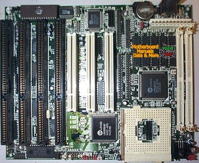

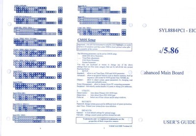

Thanks to some hints here, I think I've tracked the board down to be: SYL8884PCI
http://motherboards.mbarron.net/models/486pci/syl8884.htm
187.59 KiB
559 views
144.68 KiB
559 views
Still don't know who made it... Soyo?

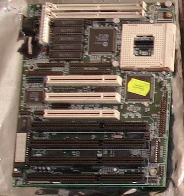

I should actually have this board, but iirc mine did come with real cache chips which were socketed I think.
Might have an old pic of this board too. Iirc mine would only work with 3.3v chips but I'm not sure as the last time I had a look at that board was years ago

Found the pic. I cut out the other boards from the pic and atm I can't take any better quality pics since my camera doesn't want to cooperate anymore 🤣

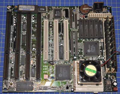

I managed to get the board to POST, and the BIOS string actually reveals it to be: PC Chips M921
http://motherboards.mbarron.net/models/486pci/m921.htm
93 KiB
519 views
These boards look so similar. And the board does indeed have fake L2 cache!

Sorry to have kept you waiting, as I was going through my boxes of boards I came across another 486 board which in fact has the fake soldered Write Back 'chips' and decided to see if I had any more...and yes I did 🤣!
Another board, also with soldered 'cache' chips, except these ones actually have a 'real' part number instead of the "Write Back" lies 😜
But otoh, I read the mbarron pages and if our boards are indeed other boards as far as jumpers are concerned, I'm not sure my board would actually be of any help to you. Btw, the mbarron page mentioned your PCChips board has socketed cache chips, but yours doesn't.
Can you verify your board has the (exact) same layout as the one on mbarron?

Reply 8 of 11, by j^aws
Yeah, the mbarron link has a pic I posted just above, and my board looks to have the exact same layout:
1) They both have the v1.1a by the keyboard connector
2) They both have the 4-pin header by the keyboard connector
3) Below the 4 ISA slots, they have a large IC, and next to this, they have a 2x3 header block
Your board differs from the above points.
