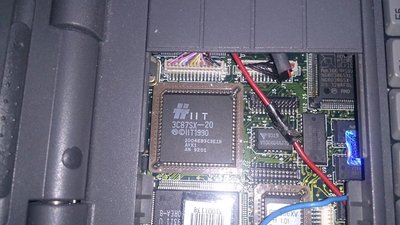

Reply 2 of 13, by matze79
This is a 387SX Package:
118.11 KiB
677 views
This IT FPU runs fine at 33Mhz 😀
Yours is a DX Variant, i think.
SX105 is SSPEC. Not Variant.
