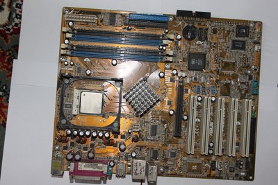

Hello guys! Short story: I bought a ridiculously amount of hardware for pennies this last weekend. I found an Asus P4S800D motherboard that looks unused but without bios chip. I only found that this chip is a 4 mbit eeprom but nothing about part code. Do any of you know what bios chip goes in there? I have several 2 mbit eeprom chips and I'm tempted about flashing one and give it a shot, but I have to see first if they are pin to pin compatible.

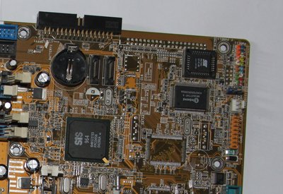

Hi Ramiro,
A few minutes with Google Image Search turned up these. Check them out, especially the first one. If the first link doesn't work for some (unknown) reason, I've attached it as well.

Also, in the manual they say "4Mb rom", so I guess that means 4megabit(megabyte??). I've attached the manual for your reference.
Hope this helps, let me know when you get 'er running!

the bios chips is a typical 49LF040 one - it's a 4mbit device (meaning 512kbytes of data)

bellarmine: I don't know where you got that picture but thank you dude!!! I can see clearly that the bios is a 49LF040.
You are always awesome guys! 😀
Now I have to find a replacement. Buying from Ebay isn't an option since I'm in Argentina and custom taxes and shipping would be very expensive. I think any pin-to-pin compatible 4 mbit eeprom flashed on an external programmer will be ok.
