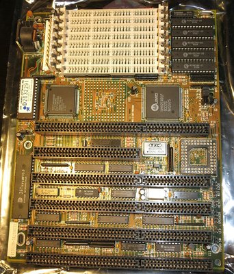

Got this motherboard sent to me by a friend. This is little too old for me and I'm lost at this tech. Could anyone shed some light on what this is and if it's worth fixing. Where can I get components needed if I decide to fix it?

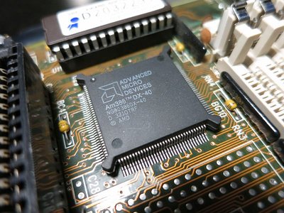

I imagine he is quite a good friend then?... if only my friends donated their old 386 mobo's from time to time.
It looks to be a pretty fast 386 board... with a fixed 40MHz frequency crystal oscillator, UMC 491F chipset, 128Kb (8 x 32K) 20ns cache / 15ns Tag, and a socket for a 387.
Yea... i'd say it's worth servicing. It looks like you may need to solder a few jumpers between points around where the battery used to be. The bios pins have not discoloured or anything and still chromed so the damage doesn't seem too extensive. You may not need any extra parts either apart from 0.5 - 1mm copper wire... and a soldering kit (if you don't already have one).
This board would make a sweet 386 system build.

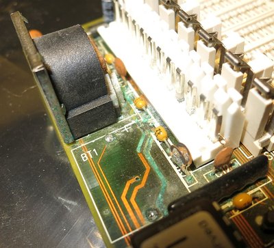

Still, if people I know were sending me 386 motherboards... I wouldn't be complaining, especially if they are not sure they want their parts back! 😁
You want to replace the caps? From the view above they seems ok... i.e. not needing changed. They may spell a different picture if you have a planner view i.e. from the side... but the few I can see, they are not bulging or about to pop... if that is the same with the rest, I'd leave them. The tracks are an easy fix... just get 0.5 to 1mm copper wire as I said earlier and solder (using shortest length of wire possible) between where the track starts and ends... so the eroded track is completely bypassed.

My bad, I missed that single ceramic disk cap near where the battery was.
I don't think these are polarized so that would make the job a little easier... rs components (http://uk.rs-online.com/web/) is what I use here in the UK. I don't know if they have a shop in Sweden, or there is Maplin for individual parts.
If you have a good camera on your phone... take a close-up picture of the other ceramic disk cap near to the one that has blown for their values. Post the picture here and I'll translate the code for you and let you know which is required i.e.. specification... but in all, you're talking nano-Farads.
Edit; - Also, if you get some vinegar and a toothbrush to get rid off the erosion before you work on it... it'll be clearer to see how many / all the jumpers you'll be needing

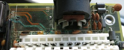

Reply 6 of 17, by 386_junkie
tayyare wrote:
I think before going into that kind of repair job, you need to see if the board boots at this condition.
There are 'open circuits' (OC's) there and a blown capacitor... it is almost a certainty that it's not going to boot.
Looking at the 2nd picture... next to the silk-screened positive sign "+" ... the tracks are wide open, and they look to be the power lines for the whole ISA bus... meaning no power to the ISA bus = no VGA, no VGA = no boot!
Reply 7 of 17, by 386_junkie
The job needing done first is to clean those tracks (continuity test to confirm OC's) and soldering wire (jumpers)... likely from the AT power connection directly to the power points on the 1st ISA slot.
If you jump the power to the 1st ISA slot... the whole ISA bus and all the ISA slots will have power.
Then you may get it to boot, if not, it'll be that ceramic disk cap.

Reply 10 of 17, by Robin4
There are good tricks to repair those bad copper traces.. First i would recommend to make pictures of that contaminated environment, so you know where to put the got parts back in the board.. Then remove anything on that area.. Clean the board with vinegar, so the acid will neutralize.
Then clean everything, scrap the bad traces away and leave the good one behind.. If you have some fine copper bread and epoxy glue you can lay a new part of traces in.. With kapton tape you can hold the new traces on the board.. When the epoxy glue is hardened, solder the ends together.
There is also some epoxy glue available for covering the top part of the trace.. If you have some patience, the board can look is new again..
Reply 11 of 17, by vladstamate
Between the CPU and the UMC chip there is an area where it looks like a socket could be placed, with enough pins that makes me think it could even be a socket for a 386. Why is it there?
Reply 12 of 17, by Skyscraper
The place for a socket is there because the manufacturer likely sold another version of the same board without the soldered 386 DX40 but with a 386 socket instead.
I even have a board with both a soldered CPU and a socket and you can chose between them with a few jumpers.

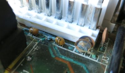

Marquzz wrote:
The blown capacitor is 47uF
This sounds a little high... does it have this writing exactly, and do you have a clear picture of it?
Sometimes with such small caps they have a number... then another number to determine how many "0's" to add after that number to determine if it's pico, nano, or micro... either this or it's letters.
Reply 14 of 17, by Marquzz
386_junkie wrote:
I've attached more images

You should use some vinegar to neutralize the battery "acid" and remove the corrosion, then clean the board with isopropanol. The busted cap is likely the same value as its friends nearby.
When fixing the board is often better to solder new wires directly from A to B instead of trying to fix the broken trace between A and B. Im no expert when it comes to this but many of my old 286, 386 and 486 motherboards have such fixes.
Reply 16 of 17, by 386_junkie
The small bead caps reading 4Z, then 10 under... are 0.1uF (micro farads). 10 is the rating, 4 is the multiplier and Z is the tolerance. So... to get your value; -
0.000,000,010 = 10pF (pico)
x 4 =
0.000,100,000 = 100nF or 0.1uF (micro)
_______________________________________________________________
Now, the flat round disc's (the blown cap) have only 2 digits... "47", meaning 47pF (pico).
The third digit if it existed would be like the "4" in the previous example above.. the multiplier. The underline is the voltage rating... for PCB's you'll not need move than a 50v cap.
As there is no 3rd digit... all you need is a 47pF ceramic disk cap replacement rated at 50 volts.
