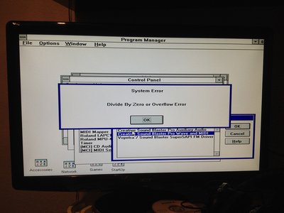

NJRoadfan wrote:
Try the Sound Blaster Pro drivers.
Thanks for the suggestion. In the likely event that I was being stupid, I've just tested this again. It still doesn't work. For completeness, here is the error:

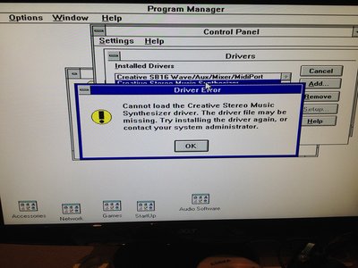

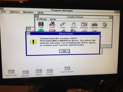

In my original post I neglected to detail specifically which error messages appear when using the official SB16 driver from Creative:
251.21 KiB
887 views
Cannot load the Creative SB16 Wave/Aux/Mixer/MidiPort driver. The driver file may be missing.
269.19 KiB
887 views
Cannot load the Creative Stereo Music Synthesizer driver. The driver file may be missing.

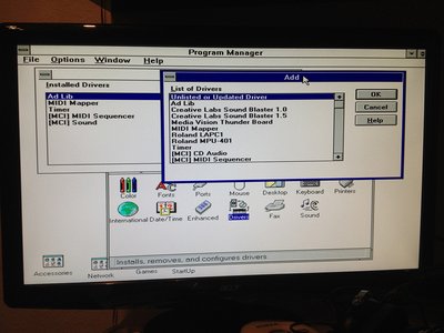

As you can see, Windows seems to list the SB16 drivers, but can't use them. I've tried selecting Adlib and SB1 + SB1.5 (these just lock up the system for a bit and cause a similar error).
Can anyone point me in the right direction? Is there not some sort of setting I can fiddle with in the system.ini or win.ini files to convince them to load properly?
