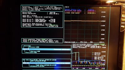

Reply 171 of 192, by agent_x007
I tested my Core i7 980X @ ~4,3GHz (22x195) without L1 😀
3DBench 1.0c : 14.4 FPS
PCPlayer (normal/NOT 640x480) : 3.5 FPS
Doom (max details) : 12247 realticks
Doom (min details) : 3034 realticks
^Not sure which Doom setting is valid, so I tested both 😉
Speedsys 4.78 (extended memory would take too long to test, 64MB used 12GB in total) : 13.79
961.83 KiB
518 views
I'm using GeForce 7800 GTX (PCI-e), no FASTVID/MTRRLFBE/EMM386
EDIT :
Default scores (same settings, minus SetMul) :
3DBench 1.0c : 366.4
PCPlayer (normal/NOT 640x480) : 476.6 FPS
Doom (max details) : 645 realticks
Doom (min details) : 142 realticks
Speedsys 4.78 : 8615.75 (:D)
848.56 KiB
507 views
Same GPU, no FASTVID/MTRRLFBE/EMM386.
