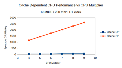

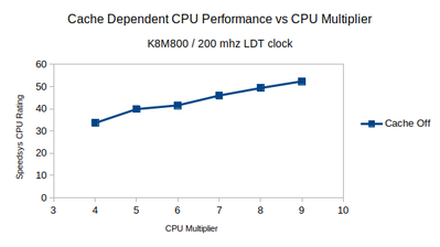

So I benchmarked a spare S754 machine to see how it behaves with cache manipulation. As I expected, performance is hit hard with cache disabled leaving too wide a performance gap (between slow Pentium and fast non Tualatin P3) to close with clock multipliers. No Doom benchmarks for the moment due to DOS4gw crashes.
