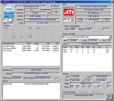

I found this thread in the search engine and proved to be quite helpful. I was able to successfully install Windows 98SE (Polish) on my T42 2374 and it's stable, so I thought I'll chime in and share my experiences.
My use case was to play some classic singleplayer games once in a while. Note that I don't have a functioning and compatible MiniPCI WLAN card, so all I needed was a system with working multimedia and basic USB capabilities.
It might get a few tries to get it right. I'm sharing my process, which I streamlined as much as I could, maybe it will prove useful to someone.
  1. I downloaded all Windows 98 compatible drivers from IBM/Lenovo official site (archive). Except the WDM audio driver that is required for emulated CD Audio. More on that later
  2. I downgraded BIOS to 3.21 to solve the problem with USB enumeration known under Windows 98SE (this has been documented in README file for BIOS 3.23) I also disabled Floppy and IRDa in BIOS setup, no reason for those to clutter the OS with unnecessary stuff.
  3. I booted up Win98SE's DOS and formatted the target drive (60GB). Note that WinXP's+ format utlity will FAIL to do so.
  4. Ran Windows setup and installed it. I skipped the creation of boot disk, also skipped the part about PCMCIA devices because I don't have any. No issues so far, after bootup it will complain about a bunch of missing devices, which can be skipped for now.
  5. Extracted the Install Support package tpisos98.exe (README) and applied the INF file that comes with it. It should add an entry to the registry. Reboot.
  6. Extracted Chipset driver oss206ww.exe (readme) and installed infinst_autol.exe, reboot. It complains about the missing driver for 82855PM. I think it can be found in C:\WINDOWS\INF, it requires the 855 driver that should be already there. If not, look in extracted package. If not, cancel, extract infinst_autol.exe with 7-zip, reboot and try again. Reboot.
  7. Extracted ICH APM fix ideapmos.exe (readme) and applied extracted registry file to resolve the conflict with Ultra ATA Storage Controller in Device Manager. Rebooted, checked, verified as fixed.
  8. Ran nusb36e.exe and followed attached instructions. Rebooted, verified. HID devices work OK, just allow to find the device wizard to install HID driver from the Windows disc. Mass storage works OK.
  9. Ran Radeon 7500 driver installer Vftp1gme.exe (readme). Rebooted, verified, no problems here.
  10. Ran WDM SoundMAX Audio driver D64z32us.exe (readme). Rebooted. Windows will ask you for a file smx.cat, it's available in C:\IBMTOOLS\DRIVERS\D64Z32US\SMAXWDM\SE. Verified, sound OK. MIDI requires one more reboot, works OK.
  11. Installed UltraNav driver Unav1i9m.exe (readme) to get that sweet ThinkPad'y middle button scrolling. No issues, just the keyboard is not working until rebooted.
  12. Installed SpeedStep 1ysue1us.exe (readme), rebooted. It's a frequency scaling utility, probably optional.
  13. Installed DirectX 9 DEC 2006 and 3DMark 2001 SE to verify its gaming potential. Got 4135 3D marks (on XP it was 3900-ish).
Observations:
  • Installing "82855PM Processor to I/O Controller - 3340" driver is crucial for loading/running 3D games smoothly. This is based on my observations with 3DMark 2001 SE. Without this driver, games were performing very poor in True Color colorspace, and in High Color they were still occassionally stuttering. Windows wasn't able to find it automatically in my case, but if it asks for it, try pointing to C:\WINDOWS\INF directory. It looks for the 855 driver.
  • I noticed that installing the ethernet driver adds additional ~20 seconds to boot time. For me, it's not worth it. Also I don't have a functioning WLAN card to compare it with. I might be wrong but I think enabling networking in general yields similar results. I suggest creating a HDD/system partition image with something like Clonezilla before installing network drivers.
  • I also don't recommend installing the Bluetooth driver. It crashed the system during install, made the system hilariously unstable, even after uninstalling it I exprienced crazy glitches and hangups.
  • Also, important note regarding the Wireless driver, per README. It requires an additional install of Windows Management Instrumentation (WMI) core components in order to run. If you failed installing it, try again with WMI installed.
  • If you want to install Cardbus PCMCIA drivers... I haven't had much luck in removing generic one after Windows has been installed, but you will definitely get it working if you put the files in WIN98 directory you install Windows from, and they'll be correctly and automatically installed. You can find more information in README under section "Unattended Install (before Windows 98/SE setup)." (archive.org).
  • I noticed no problems with missing CD-ROM drivers. I was also surprised to see my USB drives in DOS listed as regular drives. I think that's BIOS that does the job during bootup.
  • And one more general advice... If you plan on playing any DOS CD-ROM games, either from physical or emulated drive... make sure you use the first available CD-ROM drive, in alphabetical order. Many DOS games use only first CD-ROM drive they can find, very often for CD audio, sometimes for copy-protection. Reassign the drive letters from device manager if you must.
  • Tools like Hiren's BootCD 15.2 (archive) and even most recent Medicat USB 21.01 (for 32-bit tools like Acronis True Image) work well on this machine. Use them!
  • IBM's Battery MaxiMiser tray applet causes problems after quitting some DOS games and sometimes it freezes some shell components. You can disable it from Battery MaxiMiser Wizard.
All links in my post are available in archive.org. Good luck!
    31.77 KiB
    9412 views
    HWiNFO 32 Screenshot
