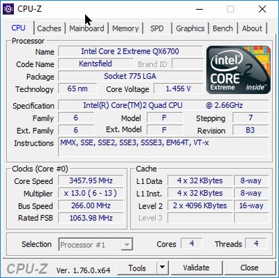

Been able to reach ~ 3.5 Ghz (multiplier 13) on Quad Core QX6700 with Vcore and Vdroop mods. It is quite an achievement as Quad Core requires twice as much juice (aka current) from those poor MOSFETS. It boots sucessfully from 1.45 Vcore, but it needs 1.5 V in order to fully run Prime95.
Probably it will hit 3.6 Ghz with a touch of FSB, but it requires watercooling on long run.
...or you'll just kill that motherboard.
Reply 166 of 701, by exxocet
You can't kill a motherboard by increasing FSB. If it's too much it won't boot, that's all.
You can kill it by running too hot, that's why I mentioned watercooling. And this CPU likes to get naughty, it goes 80°Celsius with Thermalright air cooling in full load 3.5 Ghz.
Yeah.. it will boot and die when you try to test stability in Prime95 or other intensive CPU test.
I'm pretty sure you can melt this MBs VRM under load with QX6700 as CPU, Vcore @ 1,5V and a vDroop mod on top of all that.
So... I hope you got active cooling on those MOSFETs 😁
Last thing : This board wasn't stable enough for me and my OC'ed 45nm Quad Core @ 1066MHz FSB (I didn't do a Vdroop mod tho).
PS. Is that Thermalright a "TRUE" with a high pressure fan (and good CFM) ?

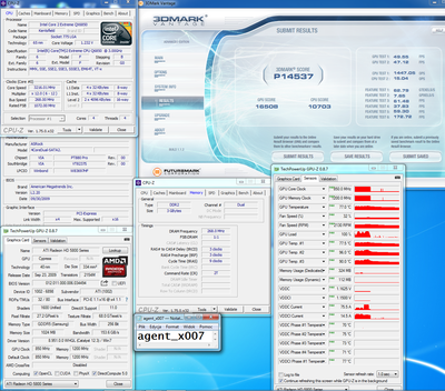

PS2. Why I don't like QX6700 in this board :
880.37 KiB
2744 views
^No voltage mods required 😀

Just little aluminium sinks on the VRM. I'm not running on 1.5V daily, it was just for the test as I've finished the Vdroop mod and I was curios if it helps. It does, before Vdroop voltage used to drop -0.1V in full load, now it goes just -0.05V.
Currently I run on 3.2 GHZ (multi 12) and 1.46 Vcore, it keeps temperatures on more decent values. 😊

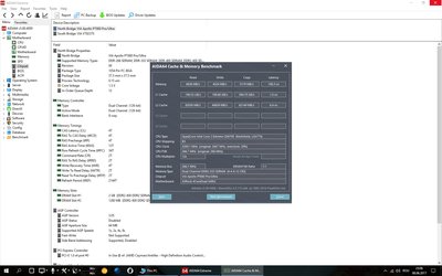

My 4Core Dual SATA2 R2.0 actually works with Dual channel DDR2 and 8-way Interleave. It might be a thing regarding the chipset, my mobo has VIA PT880 Pro, while on http://www.controsensi.it/Mods/4CoreDual-SATA … ontents_Eng.htm the same motherboard features PT880 Ultra. Now, if there really are differences, Ultra should have been the better version, at least theoretically, but...
