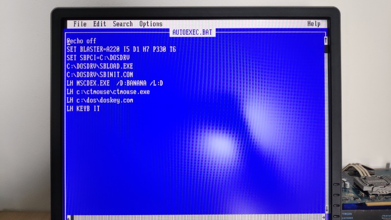

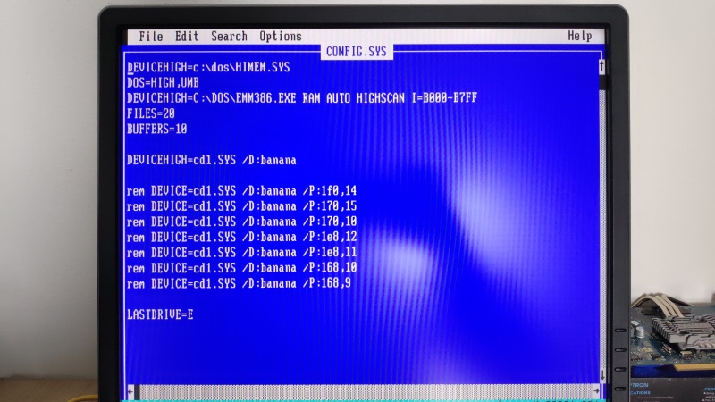

Hi there,
I really hope someone helps me.
So I try to explain better I can, I own a Sound Blaster PCI CT4750 just installed, and under Windows XP it works nice.
Now I have a dual boot system, when one hard disk starts with Windows XP SP3, and the other one with a MS-DOS 6.22 instance correctly installed.
Various games works, I read and I configured my system to free conventional memory and I always succeded in all operation.
But now the sound make me become crazy. This audio card is a PCI card, I have my system installed on a motherboard Abit NF7, so it has not ISA slot.
So i Really need to configure audio card in PCI slot. I disabled the audio from bios of the motherboard, I disabled the serial and parallel ports, I downloaded the CD driver for DOS and the install.exe command add lines to my autoexec.bat and config.sys, always the "SET BLASTER=A220 I5 D1 H7 P330 T6" and the "SET SBPCI=C:\DOSDRV".
I want to attach two screenshot of my autoexec.bat and config.sys so someone can help me.
The card is like can't be initialized. It's like there is IRQ problems, I don't really know.
It can depend from a Non maskable interrupt?

Reply 49 of 67, by biessea
Ah and sorry, this is the screen after DOS loaded all the drivers.
Thanks, any ideas is appreciated. I really want to figure out this situation so I can hear music and sounds in DOS games. And using a joystick Gameport too.

Reply 50 of 67, by Kamerat
The nForce chipset of your motherboard won't cooperate with your CT4750 under DOS, just forget about it. A card based on the Yamaha YMF7x4 PCI (running the DSDMA TSR) or Aureal Vortex might have working Sound Blaster emulation under DOS with your motherboard.
