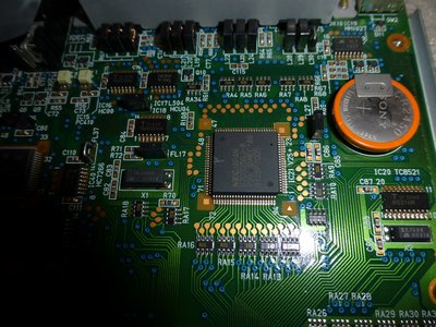

EDIT: Actually, I think I'm wrong about my assessment of the battery below... I just tested the battery with a DMM (in circuit) and it is still reading 2.9v. Upon testing the unit again, it appears that it just doesn't save certain settings. Namely, the one that tells it to sync the timing with an external midi device (which I don't need for simple playback). Other settings seem to save! So I actually won't have to replace the battery just yet... thank goodness. 🤣 How on earth do these things last so long? Is it possible that it was replaced already?
I did notice that it doesn't seem to be keeping its settings... which is understandable for a 25 year old piece of electronics. Upon opening it I see that it has a CR2450 battery in an orange wrapper of some kind... seemingly soldered in place! Is there any easy way to replace these? I have tons of CR2032s, and could probably steal a 2032 socket off of an old motherboard, but I doubt they attach the same way. Also, a CR2450 likely holds its charge for significantly longer and I'd rather not have to do this again in a few years... should I go with one of those instead? How would I attach it?
If anyone is familiar with these kinds of things, tips would be much appreciated.

Here are some pictures of the internals. I forgot to take some of the outside before tearing into it though... heh.
https://goo.gl/photos/dbZEszLWH5DUiFwH6
Its interesting to note that it seems to have a standard PC floppy drive (34pins, jumpers, 4 pin power connector) but has no twist in the cable... presumably because there's only one drive..?
Also, the power button is... terrifying! It is connected to a 7 inch long black plastic stick that presses the button soldered to the back of the board. YIKES. I'm so afraid that I'll break it...
One other thing. The floppy drive definitely works, but it seems odd that the activity light is always on when the unit is turned on. It never goes out. I'm not sure if that's a problem or not, but I was always pretty diligent about not messing with floppy disks\drives when the light was on. I can't image that it requires you to turn it off to insert or remove the disk, because it would make it highly inconvenient if you did something and forgot to insert the disk and couldn't save your work.

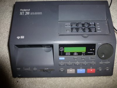

Okay, I've uploaded more pictures to this gallery!
The other items in the picture were included in the box of stuff with the Roland... aside from the three CDROMs... those were $1 each from the same place. I figured I'd grab them since they were odd and cheap. The one thing I forgot to include in the pictures that was in the box was an amazingly old-school programmable Memorex CP8 universal remote with the manual. It has an LCD screen and can "record" signals from other remotes... and it looks like its from the 80s! Its like a Logitech Harmony, only 20-30 years older... I'll add pics of it later if I think of it. I'm pretty sure it was used to control some other equipment owned by the musicians that used the MT200.
After cleaning it up and removing the sticky velcro strips from the bottom (GooGone FTW!) I must say it's in wonderful condition.

After reading through the manual I found online, it looks like the floppy disk light has a dim state and a bright state. When the drive is "ready" it is dim, when it is being accessed it is "bright". It's basically the same as any other floppy drive, except that its dim rather than off. Kind of strange, but at least I know there's nothing wrong with it. I'm honestly blown away by the lack of problems with this thing. It could be as much as 22 years old (the manual is dated 1994) and it works like new.

Regarding the battery question, yes it is possible to desolder the old one and put a socket in it's place. There is nothing special involved, just be careful to solder the socket with the correct polarity.
The CR2450 battery in the unit is a 3v lithium one with 620mAh capacity - nothing special just the solder version of it.
The CR2032 that you want to use will work fine but only has 225mAh capacity which means it will dry up sooner.
