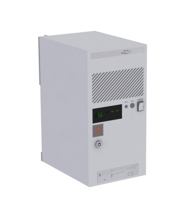

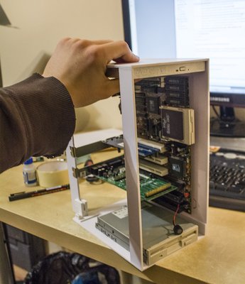

Well, I'm already working on that - but it will be a case for real harwdare, not emulator 😉 you can see the prototype and unfinished design of the front panel.

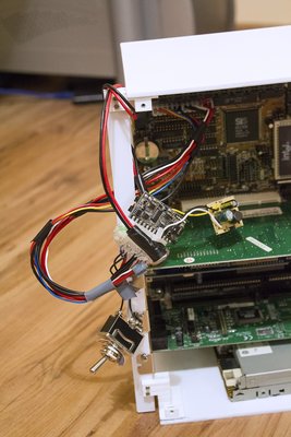

Reply 3 of 16, by adalbert
The PSU will be mounted under CD-rom - it's a "pico-atx" style, with ATX to AT converter. It needs to be used with external 12 volt power supply - so basically that mini computer will be powered just like a laptop.
Well, you can replace that floppy drive, but honestly i like old-school 3,5" drives more, and it is not a problem to write a floppy disk because USB (real) floppy drives are easily available. And that computer also has a compact flash adapter so you can just put the data onto CF card and don't use floppies at all. The true purpose of that floppy drive is to move the center of mass to the bottom so that case won't flip over 😜
    491.93 KiB
    1041 views

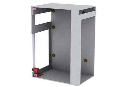

Reply 14 of 16, by adalbert
It is made of 3mm thick HIPS polystyrene boards. I ordered several cheap 30x20mm sheets and cut it using knife. The intention of that design is the possibility of easy manufacturing, without using special tools - elements are cut in straight angle. It also uses 3D printed elements (i built a 3d printer so it's not expensive to print them in home). The elements are glued using cyanoacrylate (super glue, it also creates really storng bond between 3d printed elements and HIPS), there are some reinforcements made of plastic L-beams (used in crafting models).
I didn't make plans intended for laser-cutting or milling yet, but I probably will. The width (i mean the width of mainboard) will be easily customizable, so wider mainboards will fit, but I don't want to make it taller. HIPS is pretty elastic so maybe the final version should use laser-cut acrylic, but when the mainboard is mounted and some PCI and ISA cards are installed it is stiff. I need to design mounting elemets for floppy disk, CD rom and power supply. I will update that thread when I add something new to that case.
The front panel is just an "artistic concept" for now, but I can show you how to make a basic open case which can hold expansion cards and the mainboard.
119.8 KiB
779 views

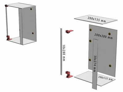

Here you can see the dimensions of elements I cut out of HIPS sheets.
Panels shown here should be carefully edge glued, using cyanoacrylate, and they can be reinforced with plastic L beams, like those
show_image_in_imgtag.php?filename=resized%2FL_SHAPED_PLASTIC_550d2c4c4727d_250x250.jpg&newxsize=250&newysize=250&fileout=

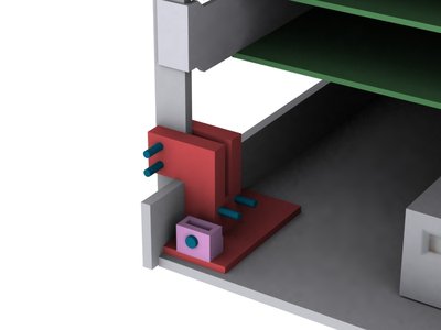

This is how the mainboard is mounted - 3d printed holder for a M3 nut, and it is glued to the side of case.
31.55 KiB
779 views

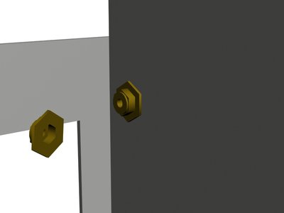

Mounting element for a bar holding expansion card brackets (you need to drill some holes). You can notice that it holds an additional M3 nut into which a bolt used to mount the side of case will be screwed. The entire element is glued to the base of the case. (those cylinders should be replaced with holes and screws)
54.9 KiB
779 views

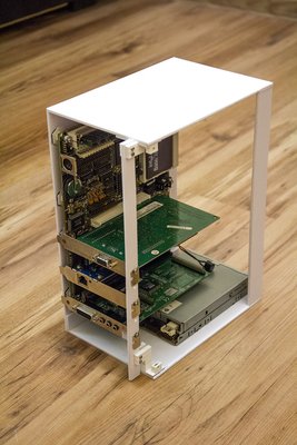

And that's the frame of empty case, still some elements are missing, I need to think how to mount a fan, COM and LPT ports, etc., drill some additional holes used for mounting stuff and so on.
42.03 KiB
779 views
By the way here you can see a horizontal open-type ATX case I designed and made earlier. But honestly I think that it takes too much space and a mini-tower design is better.
Maybe I can add another side to it so it will be converted to tower - but it will be pretty wide.
