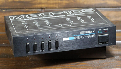

Reply 48 of 49, by AppleSauce
Kahenraz wrote on 2023-04-04, 00:43:
Wow. These are so expensive for a little box.
if you think that's bad you should see what mpu 105s go for now on ebay 😆
1.16 MiB
325 views
Reply 49 of 49, by Kahenraz
That's a cool device. I think it would be better to keep all of the devices connected simultaneously. Otherwise the other devices that aren't selected could miss out on important information that will make the music play incorrectly when switching to them in the middle of the track. It makes more sense to use an audio switcher instead.
