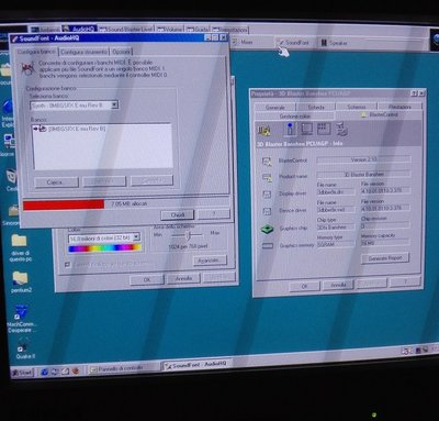

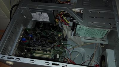

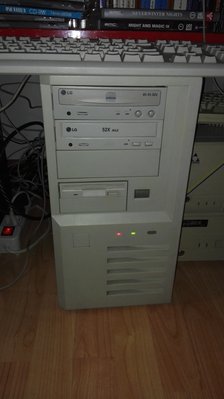

Reply 92 of 105, by mongaccio
NIce Build, FFXIhealer! Keep experimenting with the SLI, i'm sure you'll find the problem.
I did my 1998 gaming pc too!

Specs :
Qdi Legend Motherboard (bx chipset)
pentium 2 400
256 mb ram
Creative Voodoo Banshee 16 mb agp
Lan card pci
SB Live! ( i was tempted to put an awe 64, but i did find my old '98 pcb' SB Live (bought in '99)
8 gb sdcard
8 gb hard disk
CD rom and CD writer, 3.5" floppy drive
186.72 KiB
780 views
I had to place a fan on top the small stock voodoo banshee heatsink (too small IMO), it gets too hot during operation.
Had to replace some swollen capacitors on the motherboard, they were near the cpu power regulators and the agp slot. Still working fine. Latest Bios flashed.

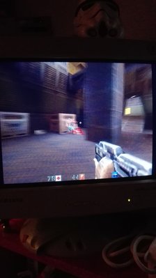

Here i'm messing with audio and video options. I really love listening to old .mid files with SbLive midi soundfonts!
And i really love playing opengl games! Wohoo! Quake 2 works !
174.17 KiB
780 views

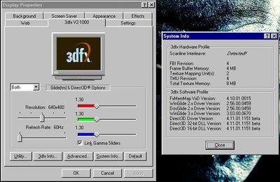

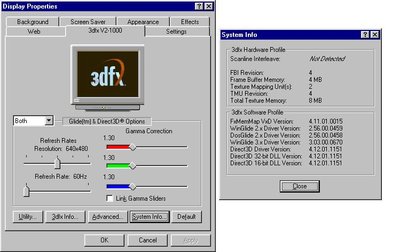

So those are the drivers. I unplugged the SLI cable before powering on the system and FIRST TIME, this shit works. Until I can figure out WTF is wrong with the SLI, I'll leave it as a single card for now. Quake, Quake II, and FF7 will play fine with only one card and I'm playing them all in 640x480 resolution anyway.
I manually updated/changed the driver for each card in Device Manager to the FastVoodoo 4.6 drivers, then restarted. Noticed that the V2 tab worked fine. Shut down the system and reinstalled the SLI cable. Powered the system back on and crossed my fingers and the tab worked!
70.77 KiB
753 views
I also checked and my gamepad is working properly too (except for up-left). I was able to configure FF7 for the cards and Quake plays just fine. I'll monitor it over the coming weeks as I continue to play through Quake 1 (I'm on Episode 4) to see if it's stable, but this is promising.
But I did notice.... on the last working SLI tab, it used to say 8MB Frame Memory and 16MB Texture Memory...that's an aggregate total of both 12MB video cards together. Now admittedly this is misleading because the two cards are operating in parallel in order to speed up total framerates or to have increased screen resolution and are NOT acting like a 24MB graphics card. So I'm hoping this was INTENTIONAL on the FastVoodoo's part in order to reduce confusion. It does say SLI Detected.
