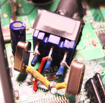

also, I think good question to be asked is - why in the 1st place such migration to 24MHz was needed?
I have a hunch for that one: ADPCM. On all sound blasters before the SB16, the 8-bit DAC was directly available on one 8-bit output port. On the SB16, you need to tunnel DAC values through the bus interface unit, instead of doing just a port write. As ADPCM decoding is implemented using a timer interrupt (or a DAC port empty interrupt on the SB16) which runs in background, just as 0x14 and 0x1c playblack commands are, too, there is a lot of interrupt handling overhead, and adding the X-Bus overhead for the DAC write in the ADPCM decoder might make the highest ADPCM rates that works on an SB 1.0 fail on an SB16 if the DSP clock isn't increased.
Reply 1002 of 1053, by mattw
mkarcher wrote on 2023-10-18, 06:24:
... might make the highest ADPCM rates that works on an SB 1.0 fail on an SB16 if the DSP clock isn't increased.
interesting, maybe I add 2 crystals (12MHz and 24MHZ) and switch between them, that allows easy way of testing what works and what not in 12MHz case - like the "oscillator-switch-mod" I saw user @jaffa225man posted here on Vogons regarding Roland device:

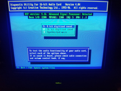

I tested 4.16 on a CT1740. Apart from making an amusing screenshot it worked fine but still clicked in DOTT.

maxtherabbit wrote on 2023-10-19, 00:23:
ı guess that more or less confirms the clicking is not DSP related and solvable with a code fix?
Reply 1010 of 1053, by georgel
Obviously the clicking is not related to firmware. If some of you have factory modded SB cards with wire(s) and probably SMD capacitors attached additionallynear those wires would be good to test them if they are clickng too.
