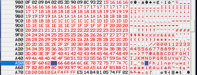

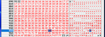

It already is! I have discovered for example there is a bug in the frequency conversion table in the 4.05 and 4.11 firmware that is fixed in the 4.13 firmware. It appears one of the values was shifted one bit to the left. That might explain this strange graph posted on a Dosbos-x Github issue (I forget the number) where there were dips at regular intervals.
That, and there's a lot of handled Fx commands in the DSP that are totally undocumented.
I'll be honest, before this project, I didn't know anything about 8051, ahaha.. part of my post here is a call for advice or even assistance from anyone who might know more.
    20.36 KiB
    1491 views
    21.8 KiB
    1491 views
