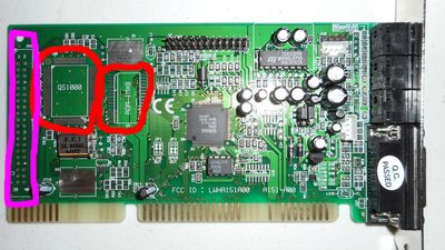

They Audician 32 looks as though it can have an optional extra chip (circled in red) and an extra header (circled in pink) what are these for?
310.07 KiB
564 views
Photo courtesy of www.philscomputerlab.com. Edited in GIMP.
The extra chip is for a wavetable solution, I'm guessing there's several versions of the card.
The header is for an IDE CD-ROM, not necessary for a socket 7 system.
Reply 125 of 189, by gdjacobs
Yes, I believe the pads provide room for an OPL4 MIDI/FM solution, YMF704 IIRC.
Reply 127 of 189, by gdjacobs
Maybe, if you can find it and if you're good at SMD soldering. It's a QFP package, so definitely doable as compared to BGA.
Is it worth it? I don't think so. You're better off buying a Dreamblaster S1 or running something external as the YMF704 wavetable ROM is nothing to write home about from what I hear.
