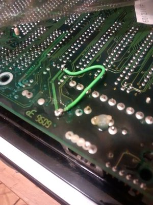

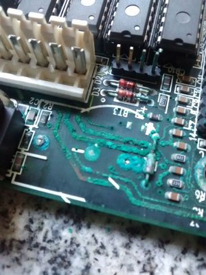

I found a computer sitting on the side of the road that had a 486 motherboard which is a SYL8884PCI-EI0 and a 486DX2/66

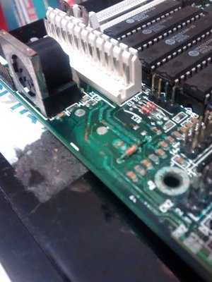

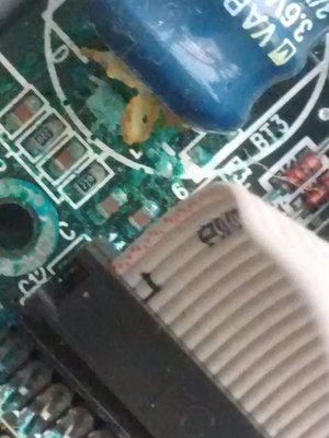

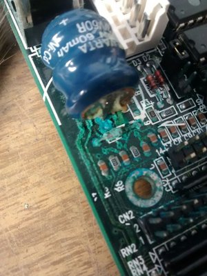

The board DOES work but had one of those leaky Varta batteries so I took it off and I was amazed how much acid did the battery leak oh god
Sadly yesterday after trying to desolder the old battery I broke a trace and I did fix it today with a wire but the problem still persists, the computer does no longer save the BIOS settings doesn't matter it is external or internal battery, I think that I screwed up u.u (I did try a CR2032 battery with some wires going to a 4 pin connector and did not work)
Here are the pics

The little acid leaking demon

Oh god, that corrosion

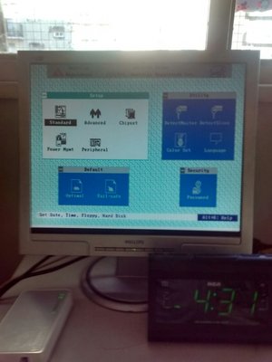

AMI's strange WinBIOS that is programmed on the board, this was taken with the battery removed

Reply 1 of 9, by psychz
I don't think that there is much you can do apart from checking everything for continuity near the acid-affected area and fixing broken traces...

Reply 2 of 9, by nforce4max
Just clean and treat the board so that it doesn't get worse, you may need to wire a battery or a pack to the pads where the old barrel of cancer once was. I have gotten lucky with my boards so far despite not having a battery installed that I can set things up save and then reboot going on as normal.
Just remember to use some vinegar and scrub to deactivate the acid then wash in warm water and soap. I often wash boards multiple times just to make sure that all the acid is gone and to remove any other grime that has stuck on over the years. Salvaged a few outdoors systems and got all kinds of stuff working over the years 😀
Reply 3 of 9, by Logistics
This! Taking care of the corrosion should be top priority, here. You could have all sorts of sporadic continuity faults with the corrosion in place.

Yes I did try taking the acid out with WD40 since is not conductive but I was with the fear of damaging a trace so, as of now I reused the case to hold a P233 MMX but I will see the next week if I can do what you guys suggest because I actually did build a battery with a CR2032 battery and some terminals to connect it to the external battery header and nothing and today I did fix the broken trace by soldering a wire to it and didn't save the settings and always tells me about the battery being low when is nothing connected to it u.u
And to be sincere, the floppy connector on the board is so full with acid that most of the contacts are blue, but as I said earlier I will try the vinegar and warm water method, because I never did this in my life

Vinegar and scrub like an old woman 🤣 its the only way to really save boards like this. If you go through no big deal as you can rebuild the trace, I've done this too although very poorly. Use some very very thin wire that isn't coated and solder the ends where the trace is good then seal it in place with something to keep it in place.

Reply 6 of 9, by TheMobRules
Just wanted to add that the blue stuff that leaks from those batteries is actually an alkaline substance, not acid like in cars, that's why an acid like vinegar is suggested to neutralize it. For that same reason it is important to fully clean the vinegar with water after you're done neutralizing the leak, if you leave some remains of vinegar it could generate another corrosion problem in the future... and your board will smell badly. 🤣

I would use Kapton tape to seal those wires and traces. And if you're going to use a coated wire, use wire wrap wire.
Reply 8 of 9, by BloodyCactus
thats into the traces now tho.. in a year youll find it creeping up in unknown places. once its between the layers, not much you can do

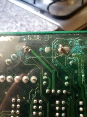

Well guys I did try to clean the board with vinegar and scrub and soap & warm water so now is drying on ambient temperature but I don't believe that I ruined the board
1.57 MiB
353 views
1.62 MiB
353 views
The trace that I fixed yesterday
