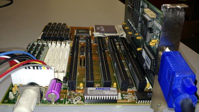

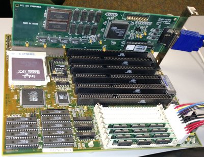

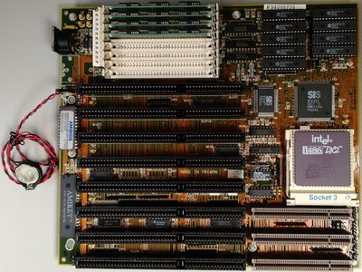

I came across an ebay listing for a 486 VLB motherboard with a DX2/66, 256kb cache and 4MB. Not much info, not even whether it worked or not. Price was $39 shipped. I was tempted, but knew I didn't have an AT case, keyboard, PSU, etc. I posted it in the "Ebay auctions cheap/special not for me, but maybe for you?" thread. The next day, I noticed it still hadn't sold. I thought some more, then decided what the heck. At the same time, I bought an AT to PS/2 adapter ($2.50) and an ATX to AT PSU adapter with power switch ($8.50). I already owned a VLB graphics card (the only 486 component I held onto from back in the day). I looked at the controller cards, but they were much pricier than I expected. Minimum $30 for a VLB card, and not much less for an ISA. So I bought the mobo, keyboard and PSU adapters for $50 total and decided to wait for better prices on the I/O card. The motherboard arrived looking brand new. Barrel battery looked new too--no leakage whatsoever. After I hooked it all up on the bench, it powered on! Without an I/O card I couldn't do more than go into the BIOS and poke around. I did figure out that the barrel battery would not hold a charge, so I went ahead and desoldered it and made a CR2032 adapter for the battery header. After testing, it worked. Great!
It turns out the motherboard is the same brand as my graphics card: Genoa TurboExpress 3-VL, with an SiS 85C461 chipset. I did find the motherboard manual online, but cannot find any performance info on this motherboard or chipset. Nothing in Phil's VGA database, etc. Anyone know how this board/chipset performs compared to other VLB boards of the day?
My graphics card is a Genoa 8500VL with a Cirrus Logic GD5428 chip (Rev A if that means anything). It's a total fluke that I held onto this card. I couldn't tell you why, I just know I found it among my belongings in my old bedroom when I visited my mom last summer.
So my first question is, what type of HDD support should I expect with typical VLB I/O cards? Will I need a 500MB HDD to work with them, or will they recognize something bigger? Because the smallest working HDD I have is 1GB. Just trying to plan out any additional expenses ahead of time. Here's some photos:

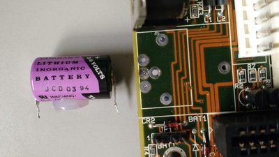

removed the old battery

new battery

If the BIOS doesn't support hard drives with capacities >500MB. you can use overlay software to access the drive's full capacity.
[EDIT]
Interesting to see that they used a non-rechargeable lithium battery. Probably the board's saving grace. You can still buy those particular Tadaran batteries too.

That is correct the bios controls the size limits for most boards, that battery that came with your board is lithium based which is good as the barrel of cancers (nicads) always loves to leak and destroy everything. Your board is nos so nice buy, just give a 1-8gb drive a try and if the board doesn't take the full capacity then it is limited. I got lucky with mine but you can use overlay software to make up the difference. Beyond that get some more ram and you are set, if anything I am finding socket 3 pretty easy to work with in my ventures.

They hold a charge pretty good, them batteries. Strange that it is dead.

So I didn't need to remove the battery. 🤣. Oh well, at least I did a clean job of it.

Judging by the year of your BIOS (1993), it likely supports LBA (>500MB) for HDDs. At least all my 486 motherboards with 1993 BIOS support LBA. In any case there are alternatives, so go with a 1-8GB HDD as suggested (or CF + adapter).
That video card should be fine, I have a CL-GD5430 which is quite similar and it performs well, has good compatibility. Do not expect awesome performance on SVGA resolutions (640x480x256c) and up, but for the standard 320x200 DOS games of that era it is more than enough.
Regarding the I/O controller, sometimes cheap options pop up on eBay. Personally, I wouldn't spend any extra $ on a VLB controller as I don't think the performance increase is worth it over an ISA card. Keep in mind that at the time the drives were significantly slower, and that bottleneck would mask any improvement a VLB controller could provide. So unless you want use specific features, such as a controller with cache, or you manage to get a VLB card for free I would stick with ISA.

Depends on how nice you want the board to look 🤣 I soldered an rechargeable button cell battery onto one of my 486 boards. 😀
Some boards do not charge and some do charge the battery, just be aware of that. 😉

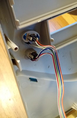

Yeah, this is what I have now:
http://www.ebay.com/itm/261220357324?_trksid= … K%3AMEBIDX%3AIT
If I could somehow mount that behind the case power button, I wonder if it would push in enough to activate.

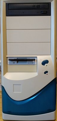

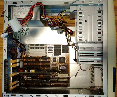

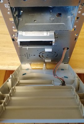

If you have an ATX case allready, then post a pisture of the ATX powerbutton. (from inside the case)
Users here might be able to help you figure out a solution. 😀
Reply 17 of 72, by clueless1
Here's some pics of the case.

clueless1 wrote:
Here's some pics of the case. […]
I own that same case!

A 486 is always something special 😀
For the power switches, in the end I used one of these 3.5" to 5.25" bay devices. On the sides there is some space and I just drilled two holes and put switches in. One for power, one for turbo 😊
You can do the same thing with a read slot cover, but then you got to reach around. Still works well.
