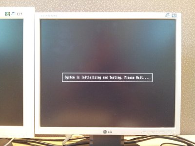

So today I rescued this cute little thin client from the recycle pile of doom. It's a TermTek TK-3350 (note: not 3550), for which all documentation seems to have been expunged from the internet.
474.87 KiB
2262 views
509.4 KiB
2262 views
Unfortunately when powered on it shows this screen and just seems to sit there. Granted there is no HDD or anything installed so I don't know what else it's supposed to do. Some POST info or whatever would be nice. No idea how to get into the BIOS either.

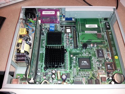

Here's the motherboard:
300.09 KiB
2262 views

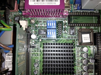

It has two banks of DIP switches at the back but I'm not sure what for. The empty socket is for a disk-on-chip module (aka solid state drive) but it also has a normal IDE connector.
349.08 KiB
2262 views
There is also an 80-pin header (on the right) which appears to be for an extremely-useful PCI or ISA riser. Unfortunately I don't know the pinout or where you would find the riser card.

It might just be the angle of the picture, but the power supply caps look bulged to me.

One thing that might be worth trying would be to pull the 'BOOTLD' chip right at the edge of the IDE connector, just besides the DOC socket. With some luck it might give you access to the BIOS.
The unpopulated 17x4 area is indeed for a PCMCIA/CARDBUS header. With a bit of browsing on digikey and a good pair of calipers to measure the positioning of the 4 mounting holes you could probably find a matching socket you could solder in.
The two sets of 4 jumpers, considering they're right next to an ADM213 (basically a ttl-to-rs232 line driver, like the MAX232) and a header marked 'TOUCH', might be to shift the lines of one of the COM ports from the actual DB9 connector to a header used for a serial touchscreen. It's likely the exact same motherboard is used in another terminal model with the screen built-in.
Pulling the battery might not be necessary; there's a 'CLR CMOS' jumper right between the battery and BIOS chip.

The sticker "bootld" on the BIOS chip is a bit suspicious... If a BIOS for this board is available somewhere try to flash it, otherwise maybe try your luck with one from a similar mainboard (chipset). The other BIOS chip next to the RTL8139 is a LAN boot ROM.

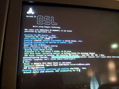

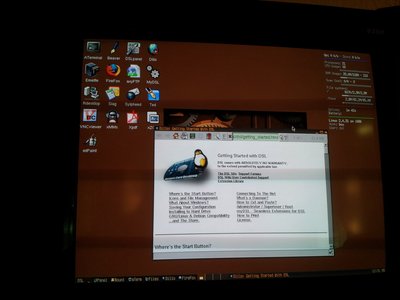

Thanks for bringing this thread back up! So I plugged mine back in and discovered that pressing F12 at the "System is initalizing and testing" screen gets you immediately into a perfectly ordinary BIOS where you can auto-detect IDE HDDs and tell it to boot from them, or various other things including floppies, LS120/Zip drives, USB devices, etc. I have honestly NO idea why I didn't manage to figure this out the last time I was playing with it, but hey, can't complain.
I stuck in a Damn Small Linux USB stick and it booted right up:
263.7 KiB
3376 views
145.72 KiB
3376 views
What can I say, it's a really nice little machine! Everything seems to work fine.
Reported system specs are a 533MHz Via Samuel 2 (C3) with MMX+3DNOW, 128MB SDRAM, onboard Trident Cyberblade i1 w/8MB apparently on the AGP bus.

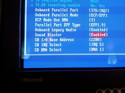

Also found these interesting options in the BIOS. Haven't tried how well they work yet. DSL says it's a VIA VT82C686 AC97 audio chipset. Some DOS testing is certainly going to be in order.
