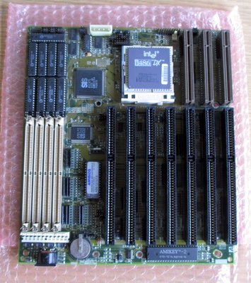

So I have got the same motherboard that LGR has. Should I go for 16MB or 32MB RAM? Do they have to be in pairs? I have a few RAM chips to choose from although just by looking at them it is hard to figure out what the capacity of some of them are. I have confirmed that I have two 8MB chips and two 32MB chips. I have some more but I am not sure what their capacity is at the moment.
486 DX4-100 (overdrive)
16MB 72-pin SIMM RAM (2x8MB)
1MB Diamond Speedstar Pro VLB video card
SB 16 Value CT2770
AOpen VI15G Socket 3 Motherboard
HDD/FDD VLB controller card
Reply 17 of 80, by TheMobRules
You have the Acer/AOpen Vi15g right?
Each 72pin SIMM slot on that board is an entire bank, so it's not necessary to install SIMMs in pairs.
Regarding the amount of memory, either 16 or 32 MB will be fine if you are running MS-DOS games and applications. Assuming you have 256KB of cache, 32MB should be the max cacheable RAM in Write-Back mode.
Reply 18 of 80, by rick12373
Yes that board. I think it has the cache not sure how much. I have attached a picture of the board. I will be switching that CPU, I have several options for that. I have an AMD DX4-100. Will that work on that board? If I have the cache would 32MB be the best option?

Reply 19 of 80, by clueless1
I have heard that there are some (maybe only a couple) of older games that do not like more than 16MB of ram. Truth be told, when 486s were new, they were selling with 4 or 8MB usually. So I would say either 8 or maximum of 16 would be more than enough for anything you would run on it.
