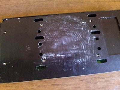

I'm trying to remove the metal plate on my PII, however there is no way to unscrew it.
1.59 MiB
229 views
Last time I tried to apply new paste on a PII I had to just pry it open and broke some plastic pieces off the cartridge. I REALLY don't want this to repeat. Does anyone here have an easier way of doing this?
Or maybe paste here doesn't matter that much and its good enough? I also see a small gap between the plate and the cache chips, do those get hot enough to warrant some thermal pads?

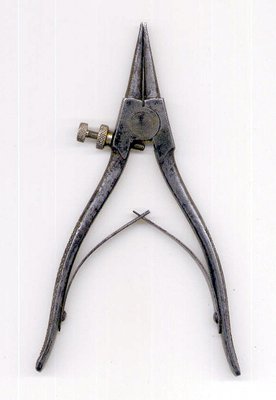

In the past I have successfully used circlip pliers to separate the cover(s) of PII SECC's.
If used carefully there occurs no damage to the casette at all. To further reduce risk of damage
the points of the beak of the plier could be 'insulated' with tape or with isolation from a wire.
    78.22 KiB
    178 views

Just tired using pliers to separate the plates like you suggested.
It worked! 😎 Thanks for the suggestion.
The plastic cover got bent slightly, but its pretty much nothing.
